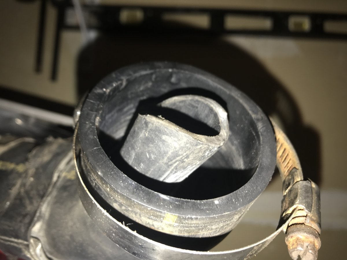

I pulled my bed off to redo the filler hose. The shop who did the original work, had replaced my fuel pump (may be a bad one) and may have damaged the o-ring seal around the sending unit. I noticed when I got the truck back, it ran like crap and misfiring and I noticed a gas smell. This was the beginning of H-E-double hockey sticks about 1-1/2 years ago.
I found that the fuel filter was leaking on the engine side and the outlets were visible and shiny so they had worked on the fuel filter. Also When I first got it back, I couldn’t put gas in it even though it was almost 1/4 tank. I pulled the box off and the new filler tube was on but when I removed it, I found that they had cut off the inner tube of the filler and it had been folded back on itself. I used a hard plastic tube to force fuel in and also got a fuel can which would allow me to fill it slowly (hopefully the enclosed photo shows the fault). I replaced the filler tube (again) and since I thought they replaced fuel pump it should be fine. D’oh!

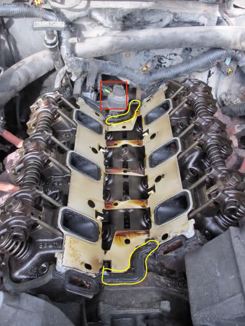

  • How to: replace valve cover gaskets, fuel rail gaskets and lower intake gaskets
First off, a huge thanks to you, 97RangerXLT. So cool that (1) you wrote this amazing write-up and (2) that you have been answering questions from people on the same thread for over 10 years!
I will be doing this project soon and have a few questions about the process. I actually started a new thread (link) since I have quite a few questions, but figured I would add them here as well since some people may follow this thread but not my new one. If you want to just answer on the other thread, that is fine - or copy and paste your response is fine too.
1. My main question is: should I try and find a one piece lower intake manifold gasket like you suggested originally? Or can I go with the newer, non-OEM two piece gasket? If I go with the two piece gasket, won't there be issues with leaks around the front and back edges of the engine block in the valley (see yellow circles in pic)? I am confused why the one-piece gasket has a gasket surface on those edges but the two-piece simply doesn't. Is it because RTV is sufficient on those two surfaces with the two-piece? Any advice is appreciated.
Additional questions I have:
2. Any general advice on using RTV sealant. How much do you use? How do you apply it (just with your finger I think)? How long do you wait after putting it down and before joining surfaces?
3. What is the best way to clean gasket surfaces? I have heard of plastic-gasket scrapers. Is that the best way? Acetone? Can I use a brass-bristle brush? Steel wool?
4. Should I take this opportunity to clean or replace the fuel injectors?
Thanks a million!

Thanks, sorry for the delay getting back to you, busy weekend.
I originally did this article because there was none and my valve cover gaskets were leaking bad enough that I was worried about a fire and was choking on the burnt oil fumes. So since it had to be done, I documented the process as I did it and submitted it.
I also have done a write up on A/C revival and I am currently writing a how to on a complete steering rebuild. Hoped to finish that before I turned 50 but that didn't happen lol.
As for the lower intake, I liked the one piece because it just dropped in and there were index pins to hold it in place, no screwing around. Plus the cost at the time was similar to the felpro 3 piece but was Ford OEM. As for the differences, I have no clue, and yet another reason to go with the OEM style. Less confusion
As for rtv, use jut enough to fill in any irregularities where a leak might occur and to hold things in place as you torque bolts down. As for wait time, just long enough to form a bit of a skin but still be wet inside. Usually a few minutes.
Gasket prep and surface prep... use a plastic scraper or gently use a screw driver on stubborn spots. I would *NOT* use any wire brush or steel wool as you don't want that debris in the engine. Tuck shop rags in the area around where you are working to keep stuff from falling down the oil passages. As for solvents, I would use gasoline or carb cleaner sprayed onto a rag (not directly on the engine) if needed.
Replacing the injectors... I didn't on mine, I just wiped them clean and put new o rings on. 10 years later and almost 195k on it with no issues. I would do the spark plugs if they need it. It would be much easier with all the stuff off.
Since you have a 91, your upper intake to fuel rail gasket will be exactly like the lower intake to fuel rail. My 97 had the plastic upper intake ad o ring gaskets. Other than that, most of your job will be the same.
Good luck!
