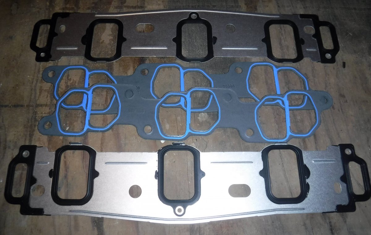

Your photo shows the lower intake gasket going completely across, but my set came with only the two sides(nothing going across the bottom to seal that part). These are all that came with my set to go on the lower intake
34799
Do you have any idea why they've made them this way, or if it'll even work for my 96 4.0 Explorer?
When I did mine (almost 10 years ago... wow...) Aftermarket had the 2 pc set up as well, and from what I remember, my research told me that the OEM Ford one piece lower gasket was better. it certainly looked like it would be easier to manage, so I went ahead and ordered it from Ford. cost me about 56 bucks if I recall. Not sure if it is still available, but if not or you do go this route, I would say to use a bit of gasket rtv to fill in the spots between the two sides.

Sorry to bring this awesome write up back to life. I am doing my 94 Ranger 4.0 and I am down to the lower intake now. My question is about Post #103 photograph. I have the exact same kit. However, my kit has the second identical fuel rail gasket AND the 12 neoprene seals for the bottom of the upper intake. When I removed my question upper intake it didn’t look like I had any neoprene seals installed on the bottom of the upper intake. My question is do I install the two felt pro fuel rail gaskets (one between the upper intake and the fuel rail and the other between the bottom of the fuel rail and the lower intake) and the neoprene seals for the bottom of the upper intake. Sorry for the long winded explanation (My OCD gets the best of me).
