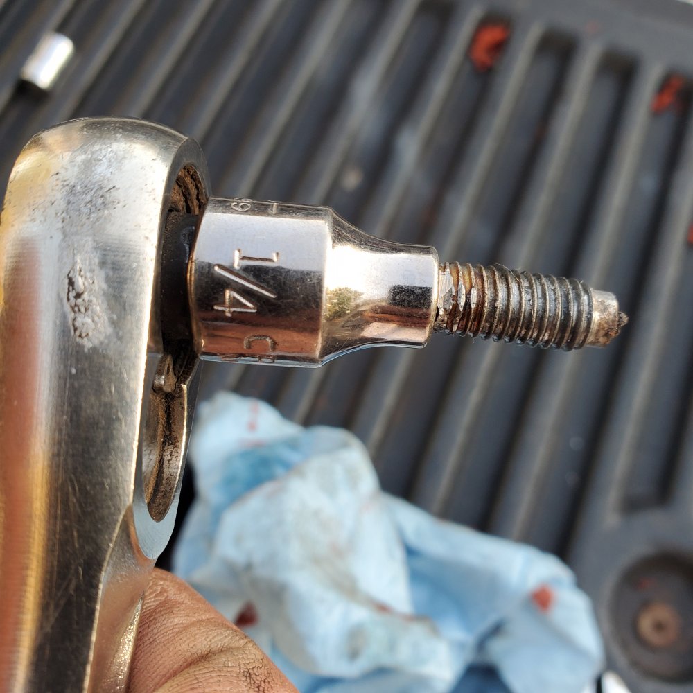

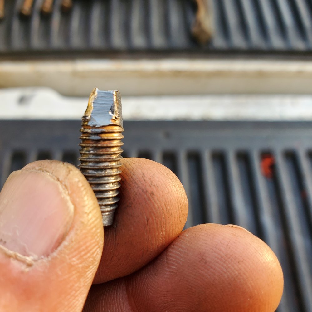

I just went through this.. luckily I had enough sticking out of the intake..
Ground it down square and beat a 1/4 inch socket on
