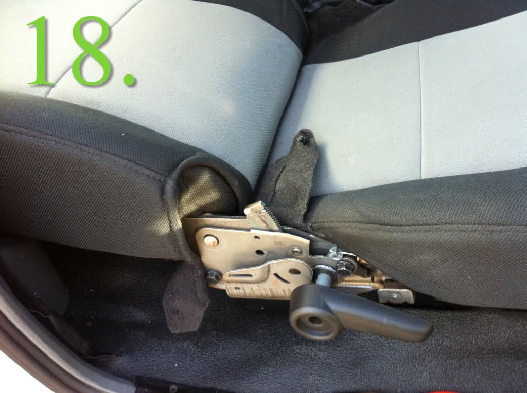

18. At this point, you can test your work! You will notice a couple of things.
That toothed gear thing does press against the fabric and plastic cover, but not to the point where it can tear or break it. This was good enough for me. 2. Remove the plastic “beauty cover”, two screws, slide it forward about a half inch then pull it toward you. Put the tilt lever handle back on.
a. That toothed gear thing does now pop up past where the metal fold over flap used to be, and pulls on the fabric. I vote “who cares” and proceeded.
b. The seat back will now tilt back completely flat with your weight on it. It will not stay in the flat position unless you notch another "tooth" in the gear, and quite frankly, that is too big of an operation for me. I’m getting ready for a nap already.
19. Re-attach the plastic “beauty cover” thing, and re-attach the tilt lever handle.
