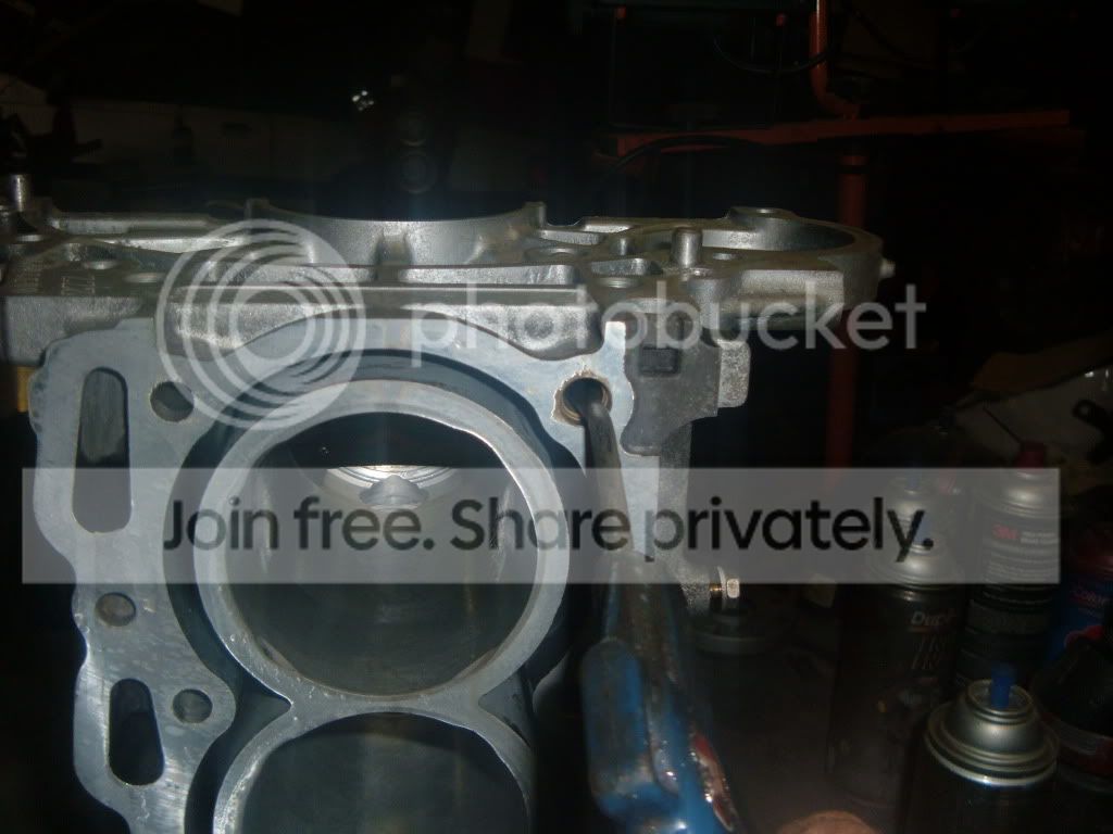

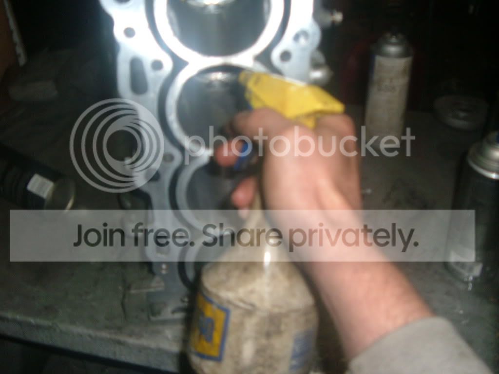

Now spray the degreaser all over the block, take good care to get the inside of the block and cylinder walls.
Let the degreaser work for 15 to 30 minutes, Do NOT let the block dry, reapply as needed.

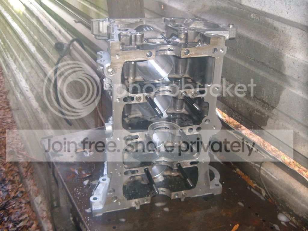

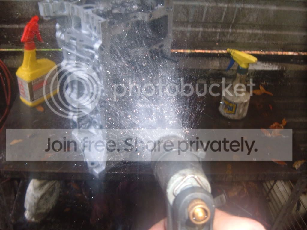

Now spay the block down with clean water till the water runs clear.
Now quickly blow the cylinders and main bearing saddle surfaces dry with compressed air.

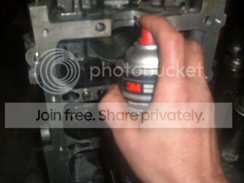

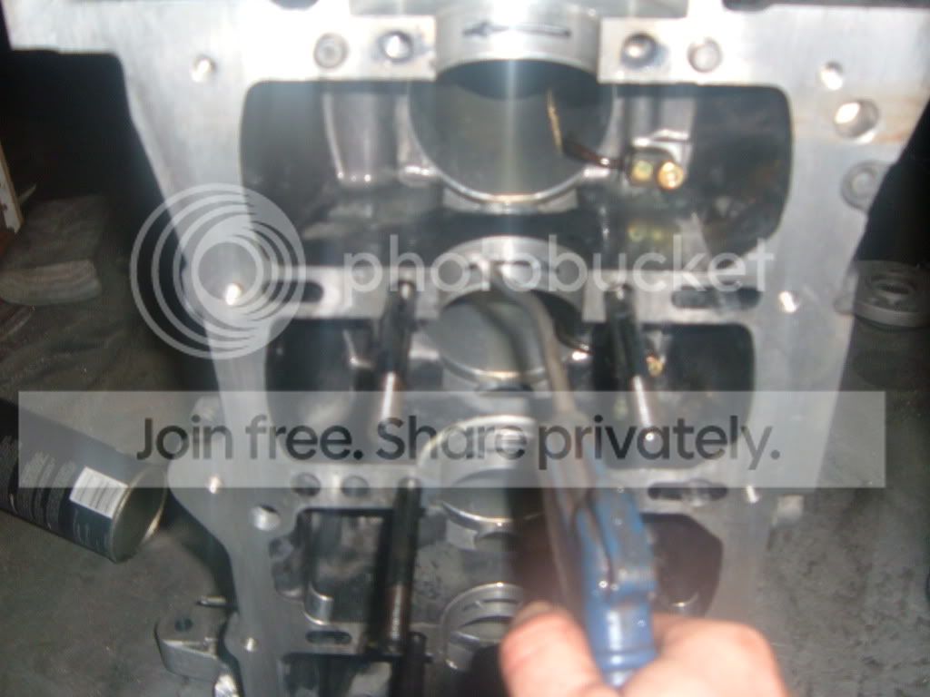

Now spin the block around and spray brake cleaner into the oil galleys, I would recommend that any oil galley plugs be removed for this step if they were not at the machine shop. Just make sure to install them back.
At this point, take compressed air and blow through all the oil galleys,
main and head bolt holes.
Repeat till all signs of grit and old oil is removed.

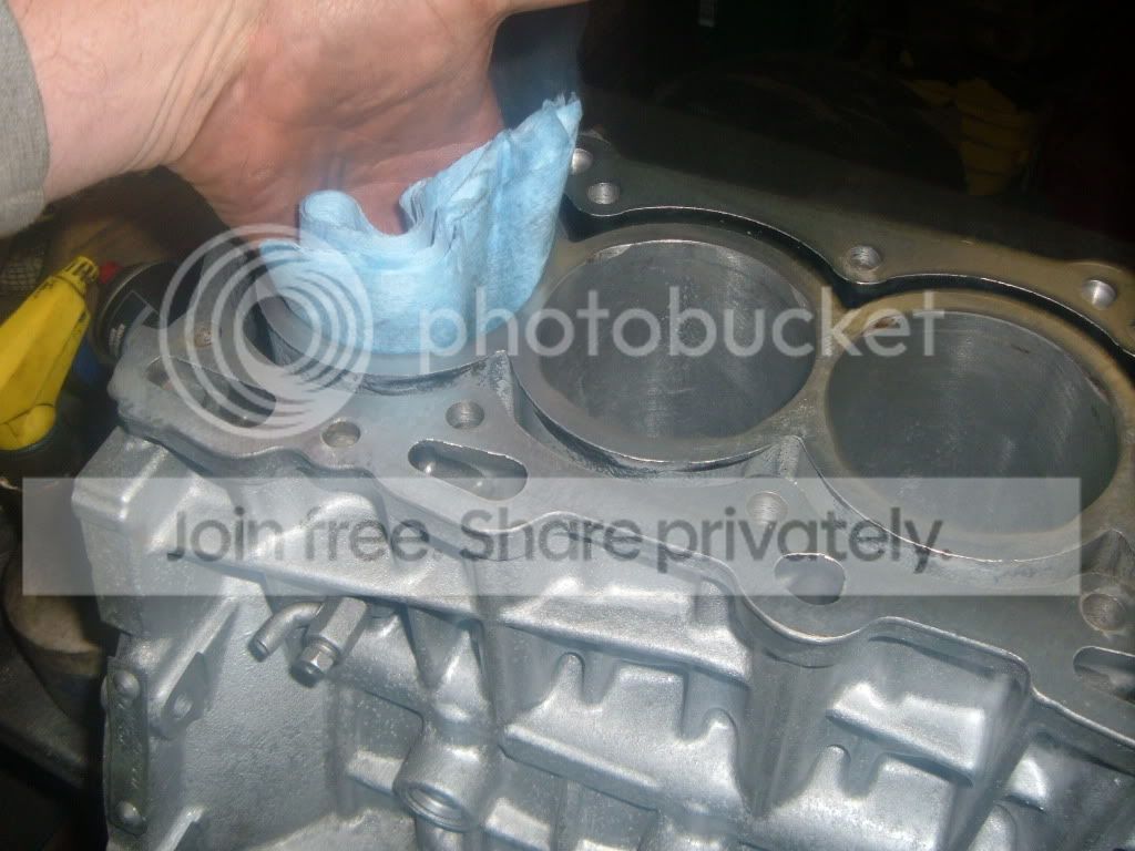

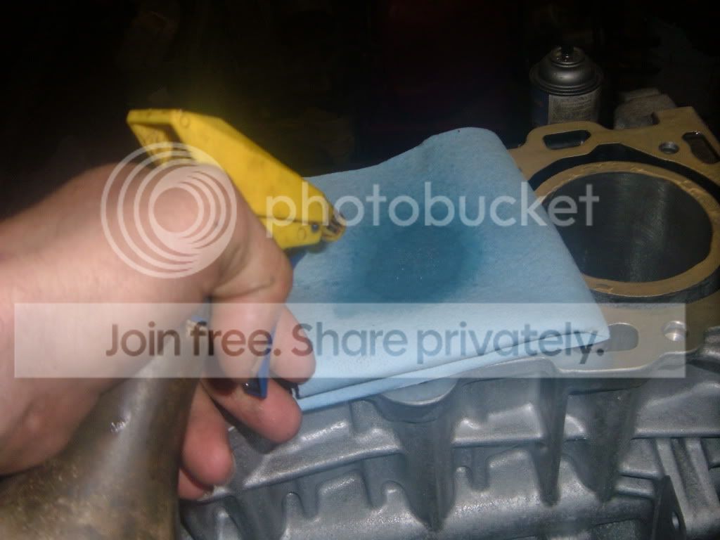

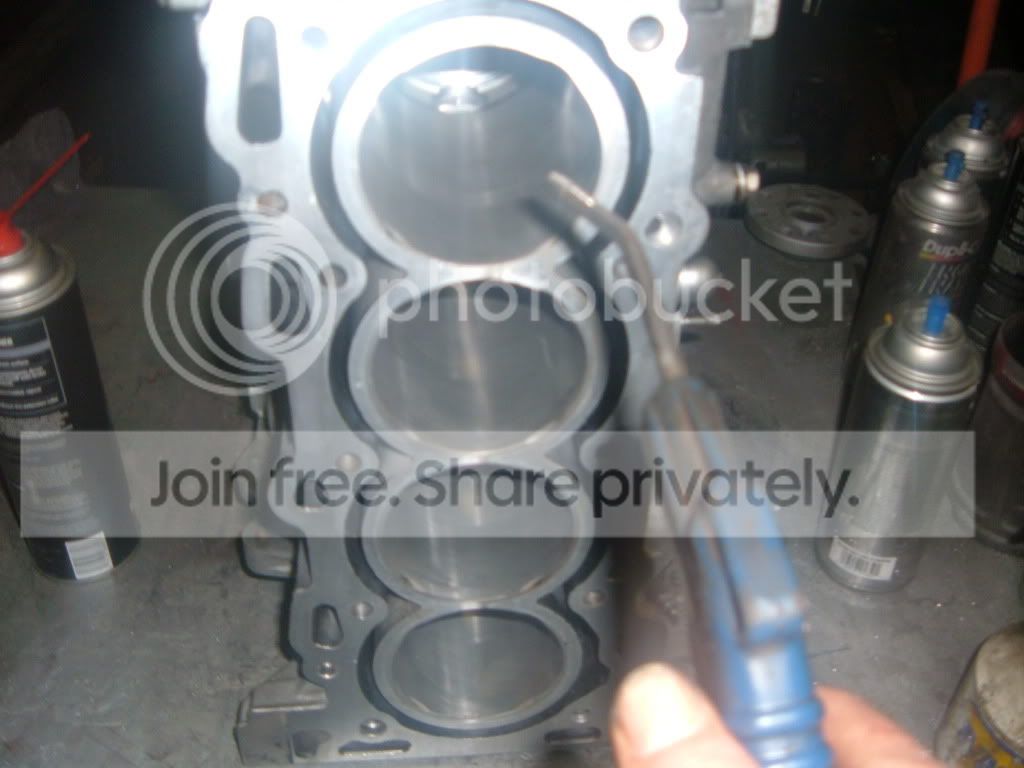

Now take a couple paper towels and fold into ¼ and spray WD-40 on them, soaking them well.
Now wipe the cylinders down

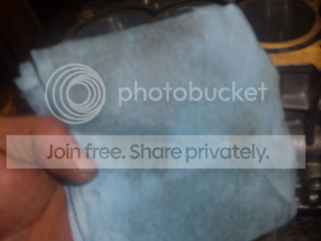

Look at the paper towel now. This is hone stone grit and rust. Leaving this in the cylinders can cause issues with the rings glazing and not sealing.
Keep flipping and folding the paper towel and soaking with WD-40 until the paper towel comes back out clean!!
