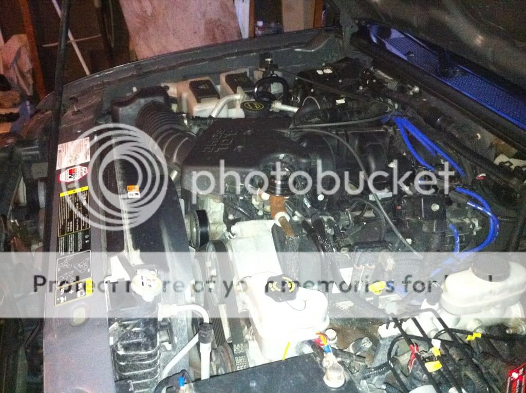

as you can see, very little room before:

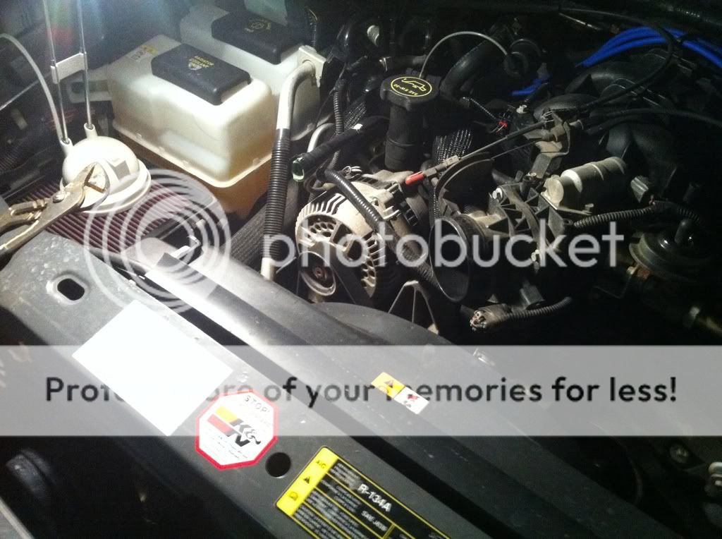

First thing to do is pull the intake:

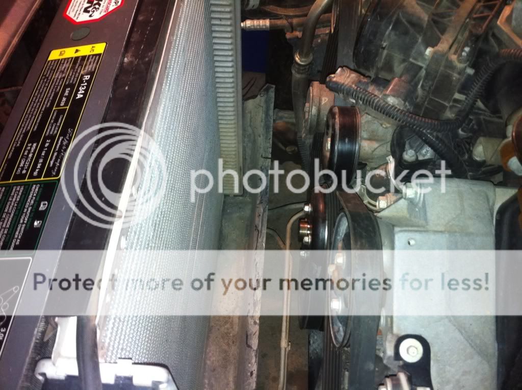

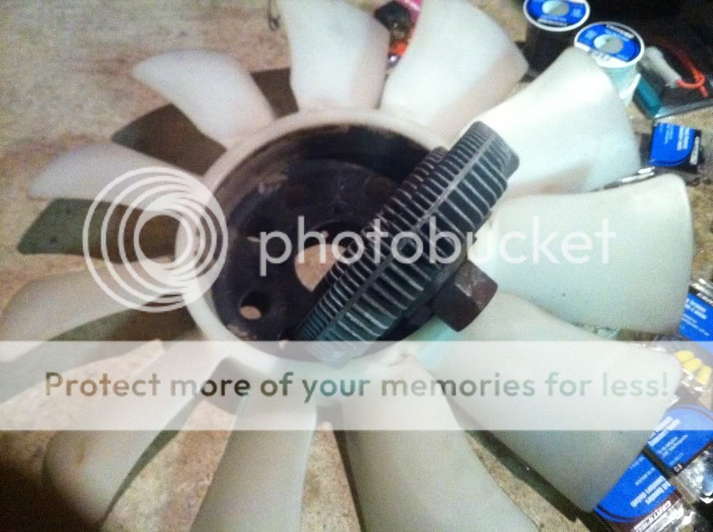

Next, pull the fan and unbolt the shroud. (2 bolts on shroud)
i didnt have the tool to remove the bolt, so i took a big hammer and a chissle and hit the edge of the bolt, and it spun off my hand. 4.0 is regular thread, right tight left loose. 3.0 is backwards (right to losen) not sure what 4 Cyl is, sorry.
Tons of space now!

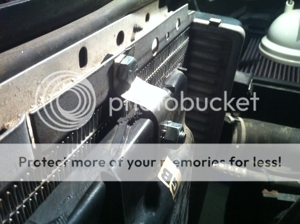

Had to make my own mounts, made out of stainless. probably 14 guage. get the fan where you want it, then setup how you want to mount it. MAKE SURE IT CLEARS EVERYTHING!!!
Waterpump clearence:
alow for atleast a half inch.
