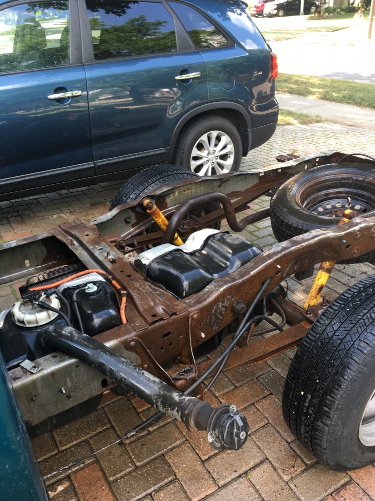

For frame rust get a needle scaler attachment for your air chisel and a set of hearing protectors. After needle scaling, thoroughly degrease - wash well with Dawn dish soap and

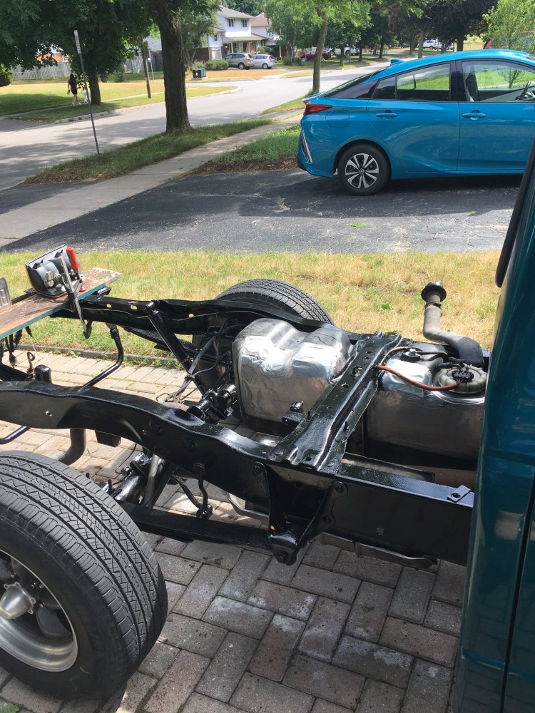

when fully dried paint with good rust paint - or if you are made of money use POR 15. (I have not had much better luck with it than with OSPHO and Sico rust paint) This is my 25 year old Ontario ranger frame ready for paint
and painted
