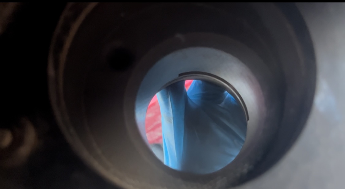

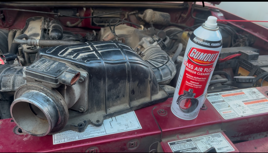

I have cracks in my air filter housing on the clean side. So need to patch that up. Figured I'd clean the MAF sensor while I'm at it with MAF cleaner. When I take it out, there doesn't seem to be a sensor hanging down like all of the YouTube videos I've watched. How do I clean this MAF Sensor?
Looks like I can unscrew the MAF sensor, but it has special tamper proof screws that I don't have the tools for.
Thanks for any tips! Sorry I'm a beginner.

Looks the same as this pic from the 87-93 mustang. I guess just try to shoot the cleaner through the screen and into the hole where I'm guessing the sensor sits? Or maybe I should remove the sensor?
Much better to pull the filament assembly out. The fasteners are "Security Torx"; you can buy the bits to fit a 1/4 drive handle; get just the correct single bit or get a whole set for not too much more.

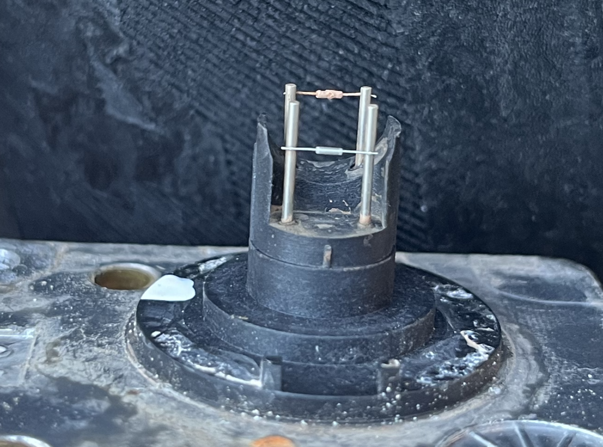

You guys are the best! I got a power torx kit, took the MAF sensor off (lots of dust, probably since there was a large crack/hole in the air filter housing on the clean side that I just taped).
Sprayed it with MAF cleaner per instructions. I think the sensor was definitely dirty. And like @RobbieD said, I think it's OEM. But I noticed one strand looked red and noticeably worse than the other. Does this indicate a failed sensor?

Your picture is interesting. I've only ever looked at couple up close and never seen both elements in glass like that. I'm used to seeing one that's just open like a bulb.
