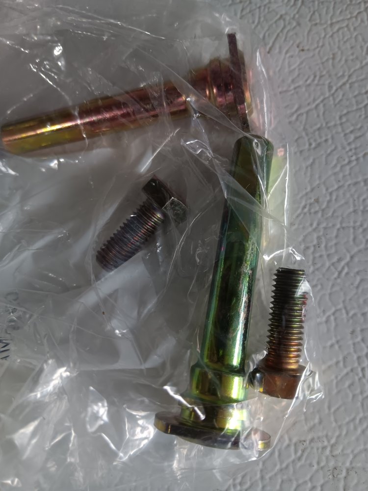

I believe they're correct for my 98 and up to 04 or 06. Can't verify beyond that. May have been a change to some M14 but the nomenclature on these thing are ridiculous. The caliper mounting bolts for the slide pins are tiny. Some pics of spares for my 98 that I have in the garage
View attachment 103516View attachment 103515
It looks like the spindles are compatible across those years, so I have to imagine the bolt fits and whatever info the auto parts sites have that shows “does not fit” for my 2011 is an error, but I won’t be able to find out until Tuesday when I’m able to work on the truck. I picked up the Dorman bolts and have a guaranteed correct one expedited from Tasca, so either way hopefully I’m covered.
