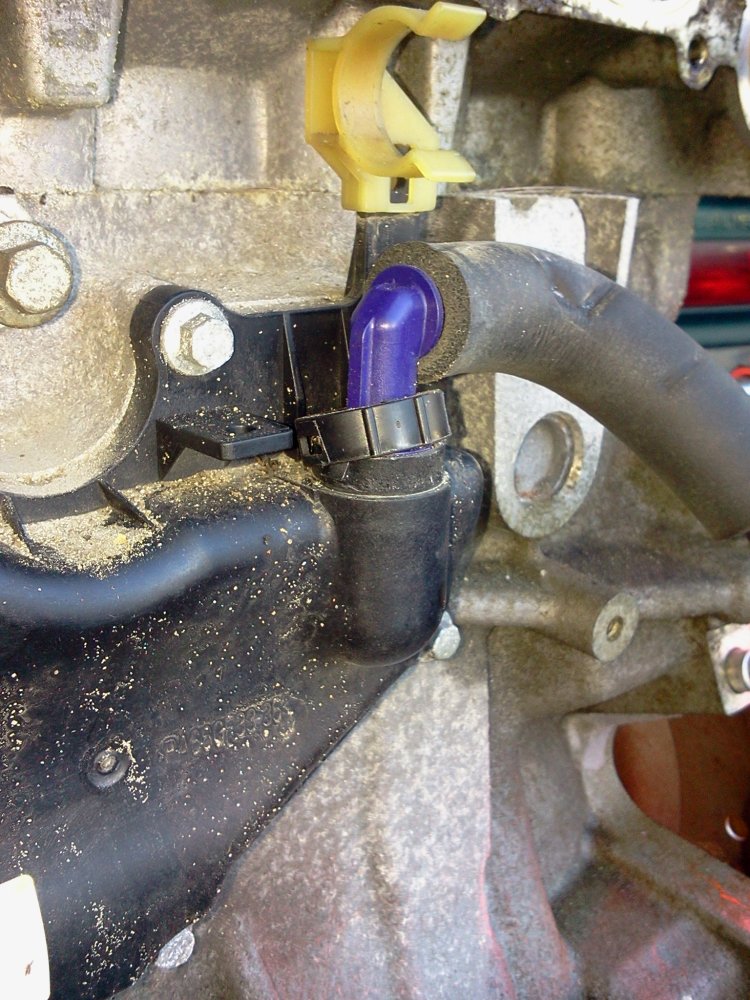

the hardest part of changing the PCV is removing the retaining ring without destroying it..
it snaps down over 2 bumps.
clean the area above it first, debris can fall into the crankcase.

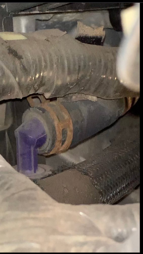

Are these retaining rings readily available from our parts store or is it something we have to go and beg for at our local Ford dealership if we break it?
I just remembered, the video I saw shows no plastic retaining ring but instead a metal clip that you pull towards you and then an easy release.
I was finally able to take a photo of mine and it does indeed look identical, even in color to yours. I suppose it means these purple ones could be original equipment. Now, the question remains - isn't it easier to just remove the wheel well rubber cover and access the valve that way? I guess as long as I'm going to spend an hour or so doing this, I should also replace the hose and take off the little oil baffle and clean that out as well.

the oil baffle is a maintenance item, I seldom replaced mine.
the pic is a 2010 Fusion 2.5 Duratec. the 2.3 in my 2005 ranger also looks identical.
the PVC hose is a 2-piece item, goes up to the port at the top rear of the valve cover.
I frequently remove the wheel well liner, putting it back on presents it's own set of challenges.
