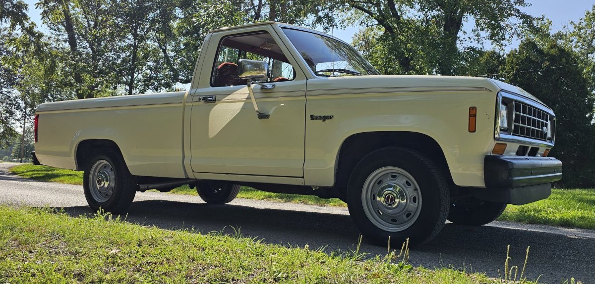

Anyone have any personal thoughts on ride quality after flipping the shackle hangers and using Dream Beams? I've read they ride like absolute garbage afterwards. Even with shorter bumpstops on the rear and lowering shocks.
I guess the rear ride quality mainly worsens after doing an axle flip.
I wanna lower this thing. I will NOT c-notch. What are my options without the rear axle hitting the frame all the time??
It already seems to need new rear leaf springs, as these sag very easily with minimal weight in the bed. I'm very familiar with first/second gen front suspension and alignments..

I'm thinking on this 85 that a shackle hanger flip is the most it will get, but I'm not sure that will lower the rear enough to match a set of Dream Beams in the front.
That djm kit the rear is lower then the front.i had to add a helper spring to even it out.It could be because I had to add stronger springs to hold up v8. Since u have stronger springs in the front like I do it won't lower as low as it should.Like if u had regular normal strength V6 or 4cyl springs. Hangers and shackles would probably be best bet. Or just get 3" drop springs for the front and call it good.My buddy just put some on his and it sits pretty good. Alignment came out good as well. But still use hangers and shackles.Either way there are options but you ll probably be taking it apart a few times until u find the correct stance your looking for.
