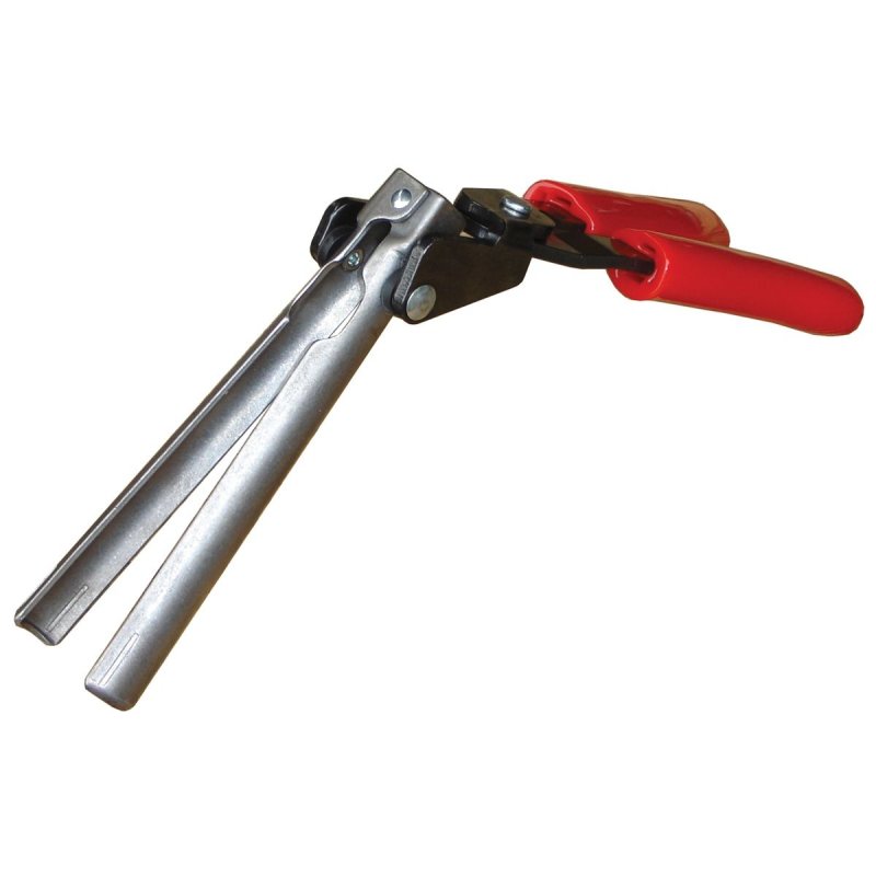

Get a boot puller. There's a bunch of different kinds but I found these work the best for getting really hard to get at wires.
Wow. Never saw one like that. I have the old style plug wire pliers. But they won't work on these. Not enough room to get them in there and they don't really open up wide enough. These boots are really shaped weird. I'll take a picture of one.
