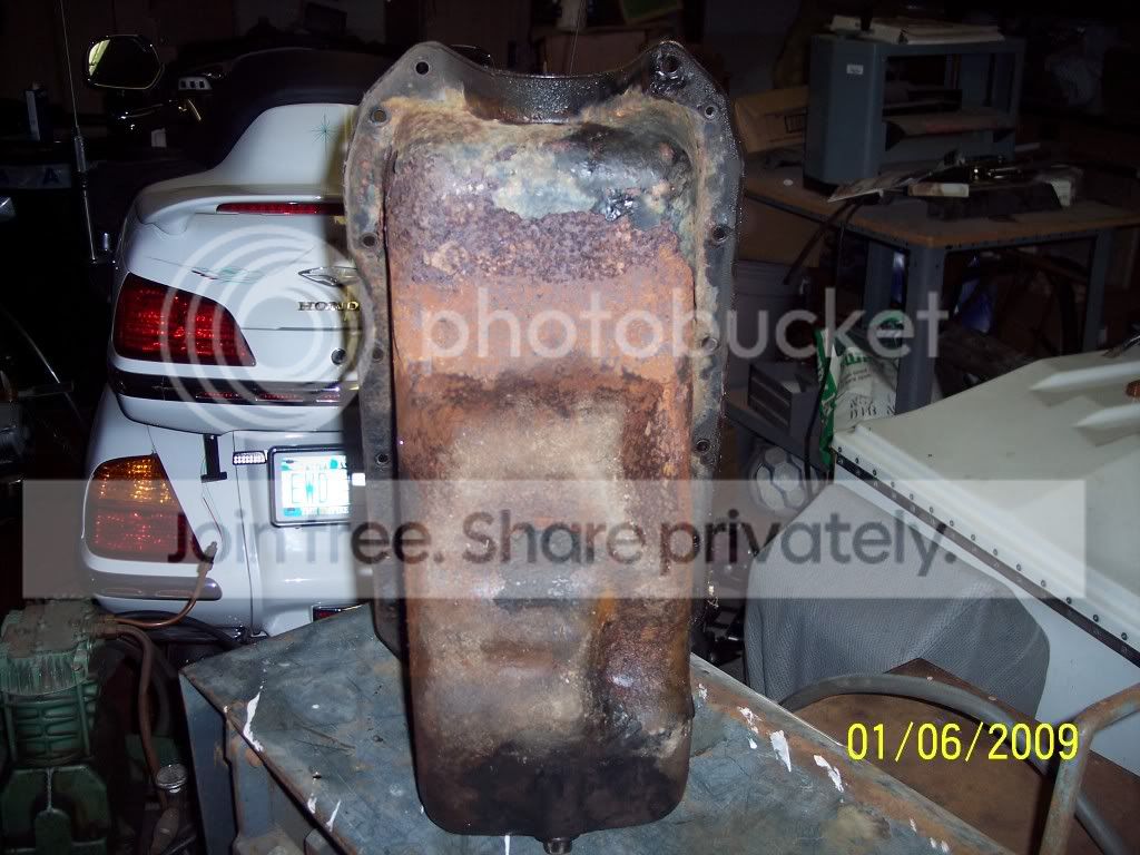

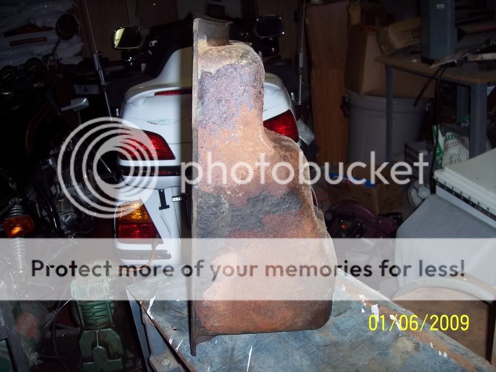

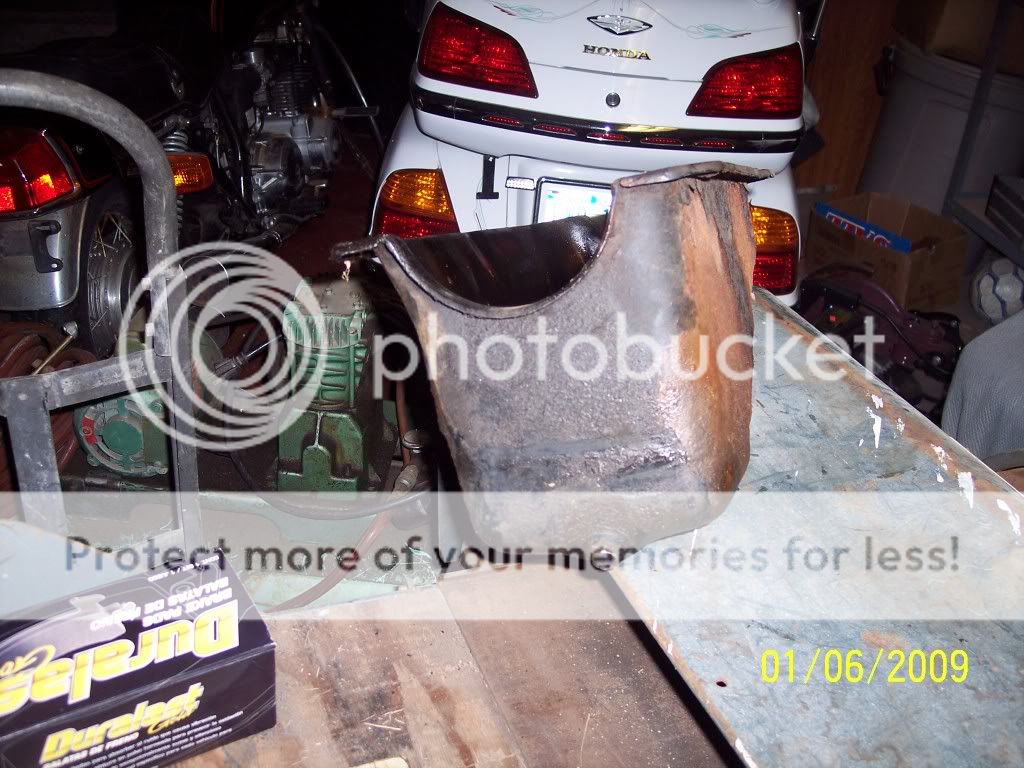

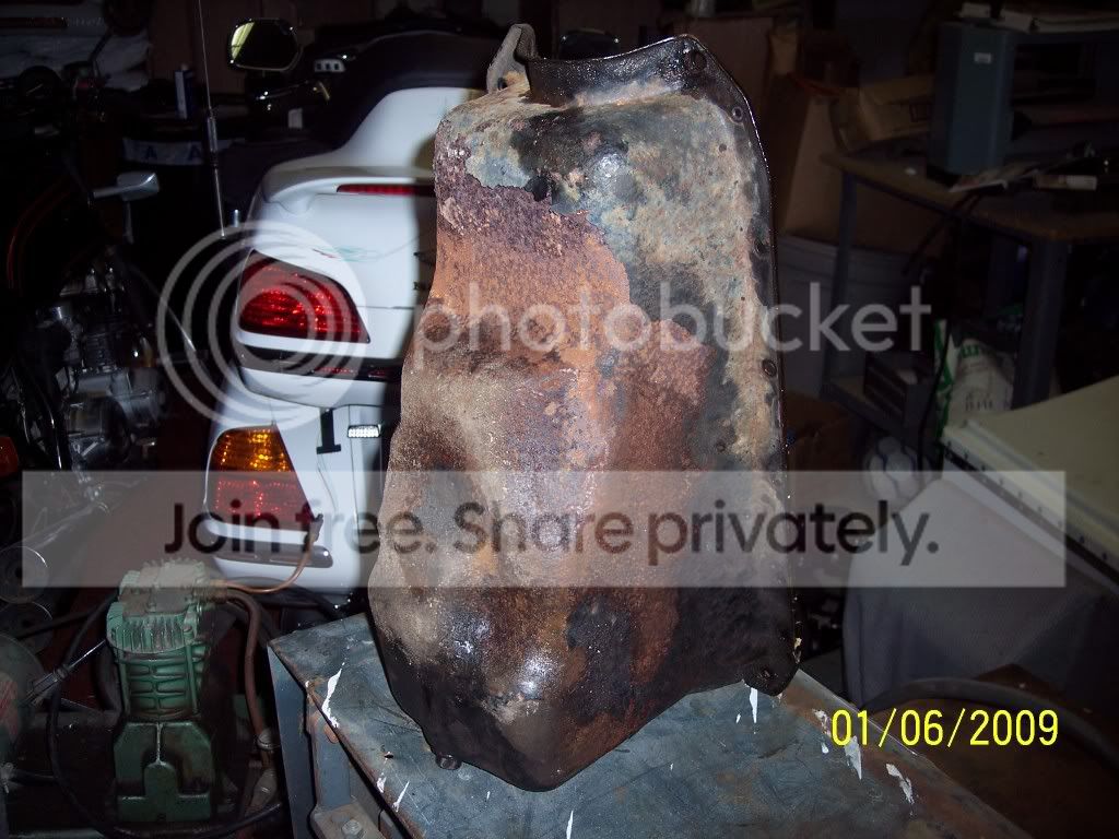

well koda if you want to pm me i have a spare oil pan i will sell you for about 25-30 bucks , plus shipping , which shouldnt be too bad since we are both in new york , it is rusty , it needs to be banded down and repainted , it came off my new 3.0 and i used my old pan
surface rust , not very bad , the engine it came off of was from a 98 with 97k miles , but the pan is just about covered in rust , but it is all surface , my pan just looked better to me at the time
So it's not really effecting the quality of the metal? Could I possibly get a picture of it?
I could probably sand it down and apply a crap load of coats of paint.
I'll talk to my old man, and see what he says.
ok , i will go over to the farm today and get it and take a pic of it , it is at the farm becasue that is where i did the motor swap , and the rust does not affect the quality of the metal
this is the pan
Oil pan
