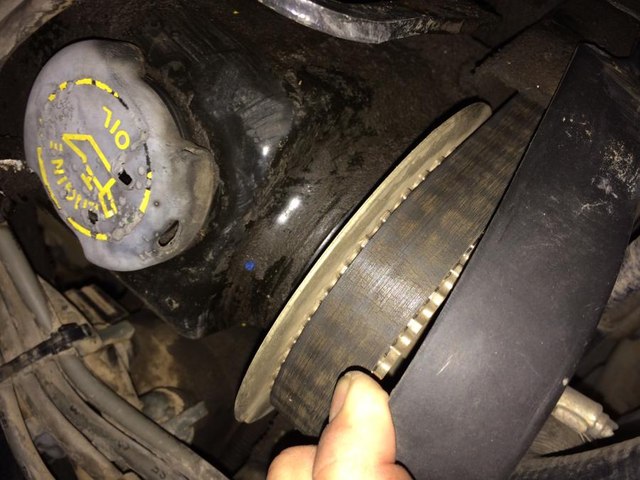

How does my timing belt look?
camelman
Sep 29, 2014
48
1997
I just bought this truck and don't know the history on the timing belt. The previous owner has blocked his number, so I can't call him either. Weird, but such is life. I snapped the attached picture of the outside of the timing belt. I can take more if necessary, but need to know how/where to take them.
The truck has 175k on it, but I don't know if the timing belt has ever been changed.
Thanks,
Camelman
It's hopefully been changed at least once. I don't think it'd hurt to do it...Just for peace of mind...
It's hard to tell from those marks. Can you get pictures of the inside of the belt? Do the teeth on the belt look cracked or anything? Is there much deflection at all?
As far as I know, it is impossible for anyone to tell the age/condition of the belt from inspection. Most failures are at startup, when the crankshaft sprocket will eat a few teeth from the belt, and then it is not in time any more. The rest of the belt looked fine as far as I could tell.
If you want piece of mind, change it. Pretty much less than $20 out the door. Most say change the water pump & tensioner, but I don't see the need as I have not had the best of luck with replacement water pumps. If the pump or tensioner bearings feel rough, loose, or squeaky, I'd replace them. If they rotate smoothly and freely, I'd leave them.

If you have no idea if/when it was ever changed, I would just go ahead and change it. The same goes for any other maintenance items you don't know about: All fluids (oil, coolant, trans fluid, diff fluid, PS fluid, brake fluid), spark plugs, fuel filter, air filter, PCV valve. Just do everything so you get a baseline that you can base all future maintenance off of.
Sounds like I need to change the timing belt. It'll have to wait until I'm off crutches, but it's on the list. Thanks for the feedback, and thanks to wizkid for the pics!
