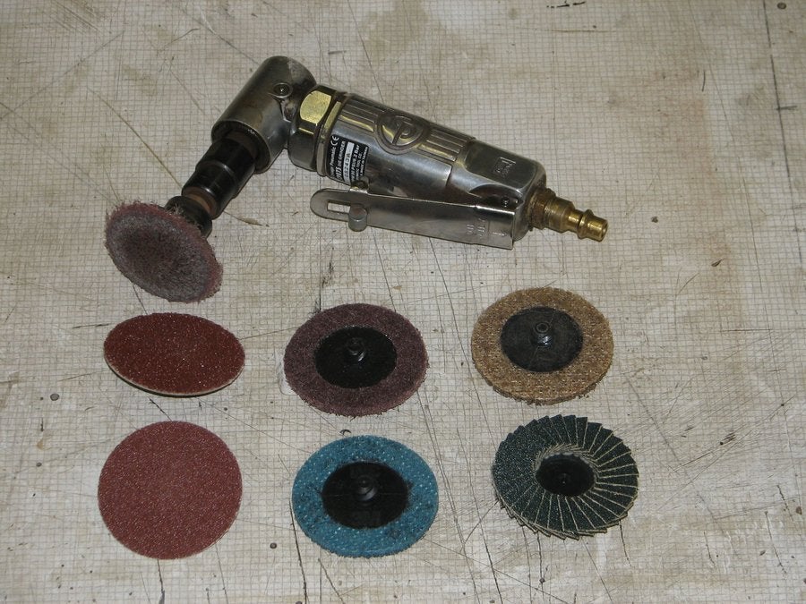

i use a die grinder with a 3m rolock disc such as
