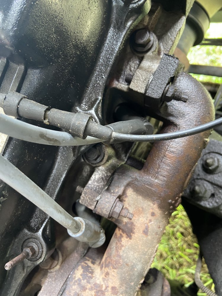

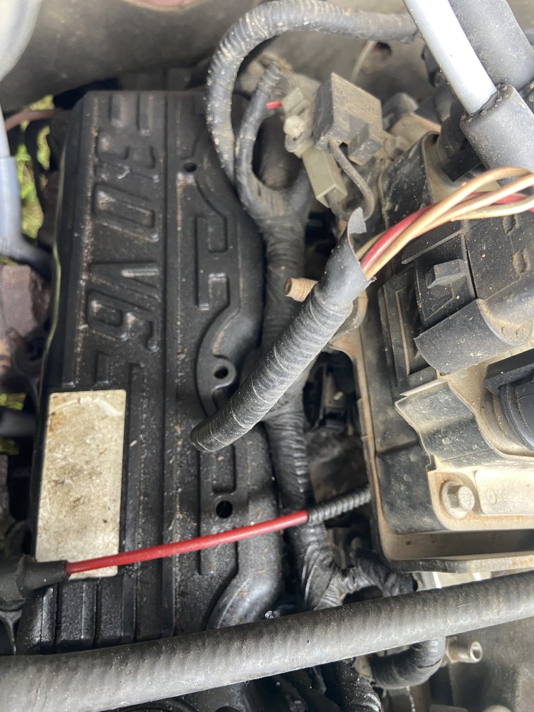

This side looks wet. Didn’t know if it lost a head gasket or what? Not sure what 3.0 we have. And didn’t know if it was worth letting my son wrench on and see if he could get it going or not?

3.0L are kinda known for the cam synchronizer locking up. This twists the oil pump driveshaft into two pieces and engine loses oil pressure.
If you think it's a head gasket... pull the plugs and see if it will turn over and push coolant from the cylinders.
But my guess is it lost oil pressure and locked up.
.....and the 2.9 gets shit about head failure?!
Pull off the belt and try and turn the crank bolt. If it turns over then one of the accessories are locked up.
