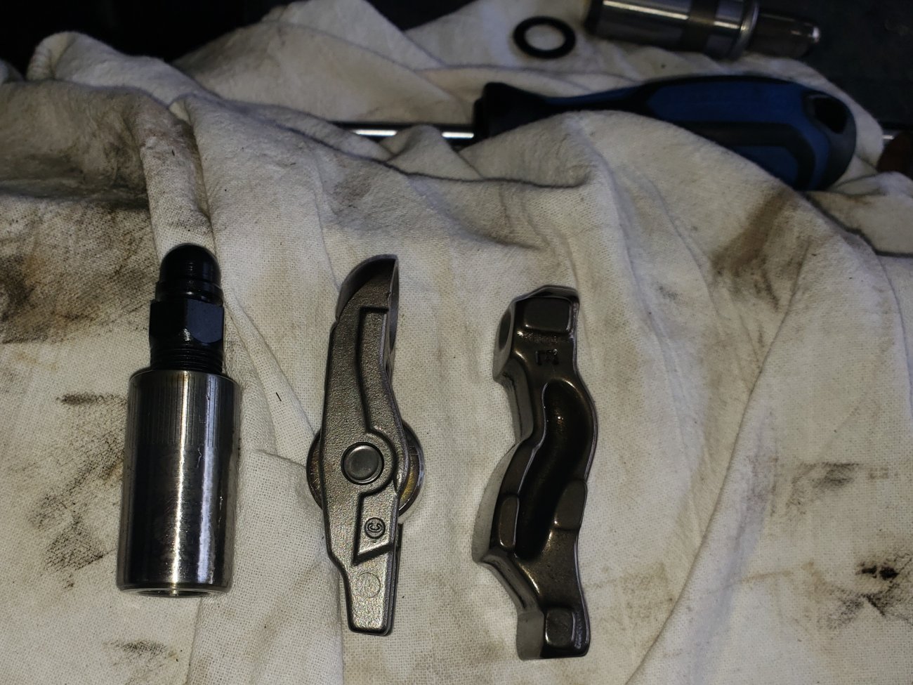

I bought a 1998 Ranger 2.3L follower (for the 7mm valves) because I was going to do this on my '89 'Stang.
Figured I'd do 1998 valves, 1998 bronze valve guides and skip the whole grinding a follower tip to fit deal.
It arrived yesterday.
All I'll say is, there is NO information on this for a reason.
Someone needs to "cite their sources" as BOTH followers are the same physical dimensions (1.475" from adjuster socket center to roller and 1.050" from roller to tip), so I don't see how the ratio can be different.

For the "alleged" Hot Cam set up, you would need an actual 1989 to 1994 Ranger Roller camshaft and a LATE head with 1995+ Head (.2750" valvestems), do not modify the cam followers... seriously.
1995-2001 Cam Follower (Incorrectly called a rocker arm) is stamped steel: F57Z-6564-A
1987-1994 Cam Follower is cast iron with a steel roller and pin: F1ZZ-6564-A
