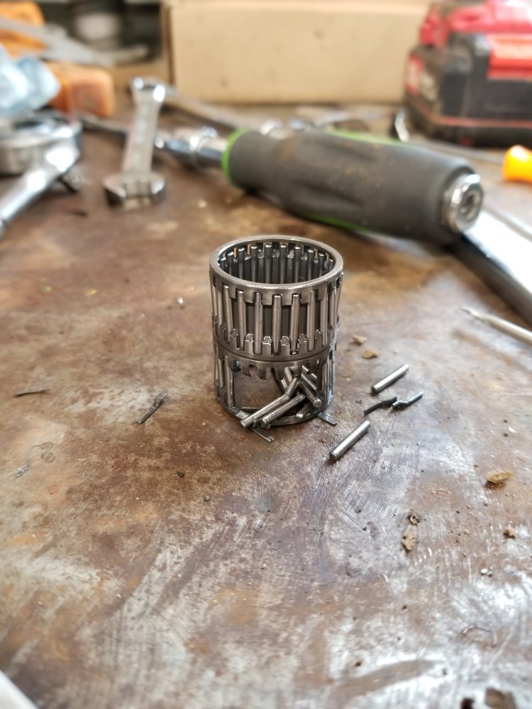

Found the cage on one of the reverse gear pocket bearings bad so now I gotta get parts, might as well get new iron nuts for the two shafts since they're supposed to be single use and have already been reused...

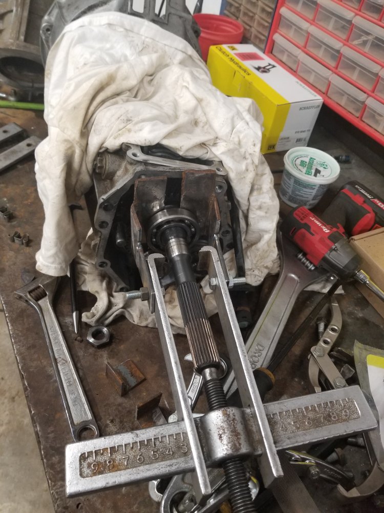

Ok, here's some pictures of the transmission rebuilding adventure... First off is the puller modification to get the rear bearing off:

Then lastly the condition of one of the pocket bearings in the reverse gear on the counter shaft

Nice. Good bearing carnage pics.
Where'd you get that puller? Thing is bad ass, I need one.
That's an older Proto puller I borrowed from a coworker, it was too short but had holes near the end so made due :), they still make them labeled as Stanley now (apparently same brand? said Proto/Stanley when I was looking) but the set is like $350!!! Gonna keep my eyes out for one at garage sales and such, I'm sure I've missed out on a few...
