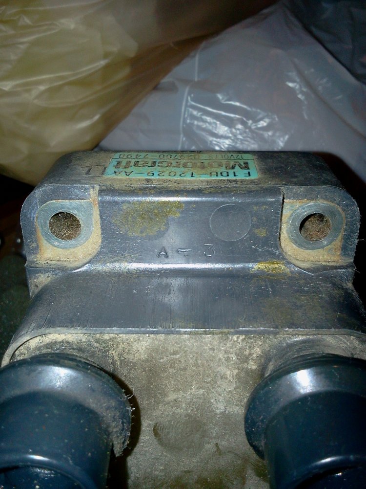

I have a horizontal coil in my parts bin, the only marking is A-3 on the end.
since your's is working it's a non-issue now.
nope. it's in a box in the basement. I don't know what Ranger it was in. Either a '99 or a 2000.
