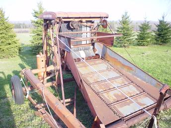

I've seen people use swather canvas before. If you've got an old roll laying around, just cut some off.

LOL, you probably won't find swather canvas at a craft store. I'm talking about canvas from the pickup belts on this.
I guess you need to be in an area where agriculture is common in order to have something like that laying around...
Ag is big here, but swathers are not. I think round balers use something similar, shouldn't be too hard to find a hulk of one to get a belt off of at a salvage yard.
My dad has one of these and I bet a belt (the grey things towards the rear under the roof) off of one would make a great gap guard, there are a ton of them laying around waiting to be scrapped too:
