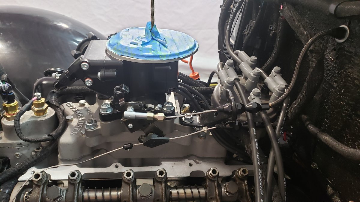

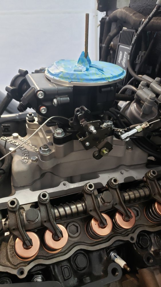

This is the offer 4bbl to 2bbl adapter with a sniper 2300 haven't started it yet. Have to modify the valve covers .
1929 model a truck. Mustang 2 running gear.
2.8l v6 Wiesco forged pistons .030
Schneider turbo cam.
I NEED MORE PHOTOS NAOUGH
This or something else.
Also got a distributer from performance distributor springed and brass bushing.

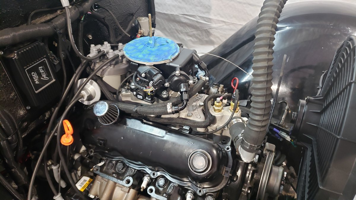

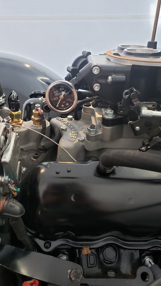

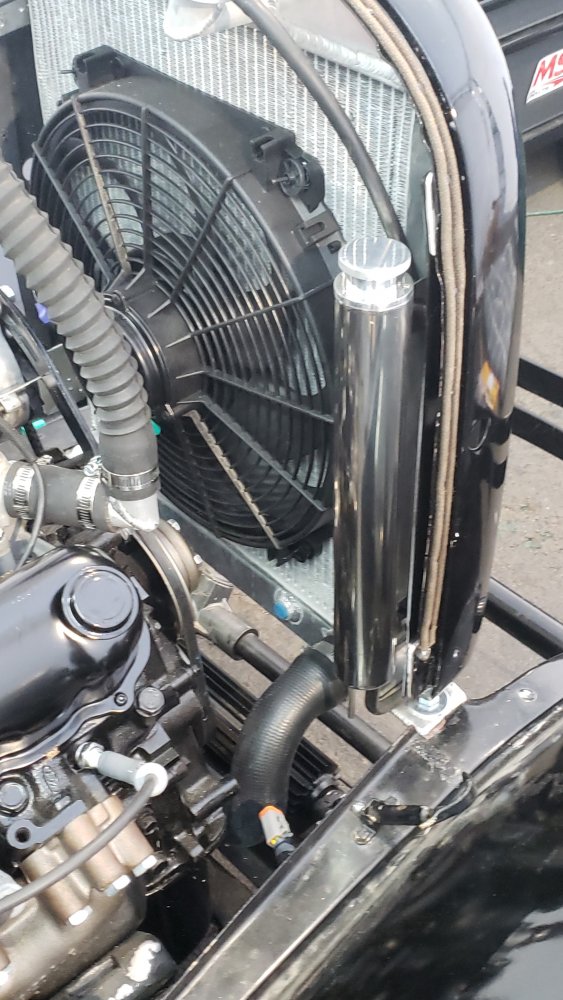

So got the valve covers modified and painted and installed got my inline fuel pressure gage mocked up and my radiator recover tank bracket built and instaled
50538
Ok so an update srry its been awhile so got the truck started had it idealing at 15-1800 rpm to break in the engine all was good but about 7 mins in it blew the bottom radiator house. So a few things to address but she gonna be driving this weekend.
