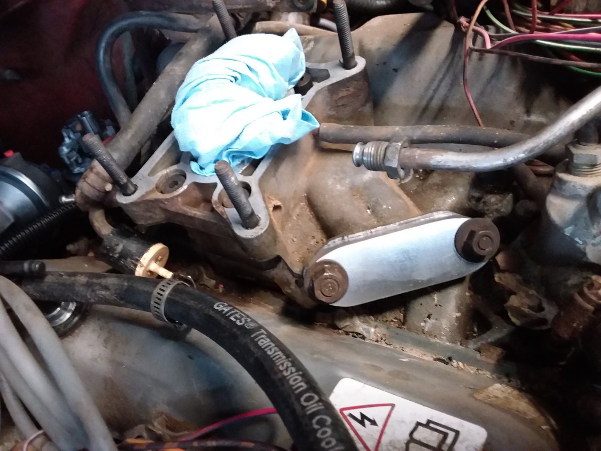

I eliminated my EGR. I had a guy at work make me a block off plate. I installed it with a gasket.

The block off plate is bolted to the EGR spacer I was talking about, take it off and look underneath it for corrosion before you spend a bunch of time and money.

I see what you're saying now, its bolted down with the 4 bolts by the intake manifold throats. That attaches it to the intake manifold.
I doubt there is any corrosion, but I will take it off and take a look tomorrow or this weekend.
