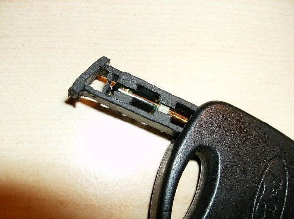

If you wire it into a key on circuit, you only need a single relay and a momentary push button to make it latching.1999 Ford Ranger with 4.0l(V6) will have PATS(passive anti-theft system) which turns off fuel pump and fuel injectors unless one of its Factory transponder keys is used in the ignition
Fuse 19 in the cab fuse panel, 25amp, powers the coil pack and the computer relay, so if its disconnected then No Start
I wouldn't disable starter motor because I like the idea of engine cranking, making noise, but not starting, this calls attention to the THEFT attempt
