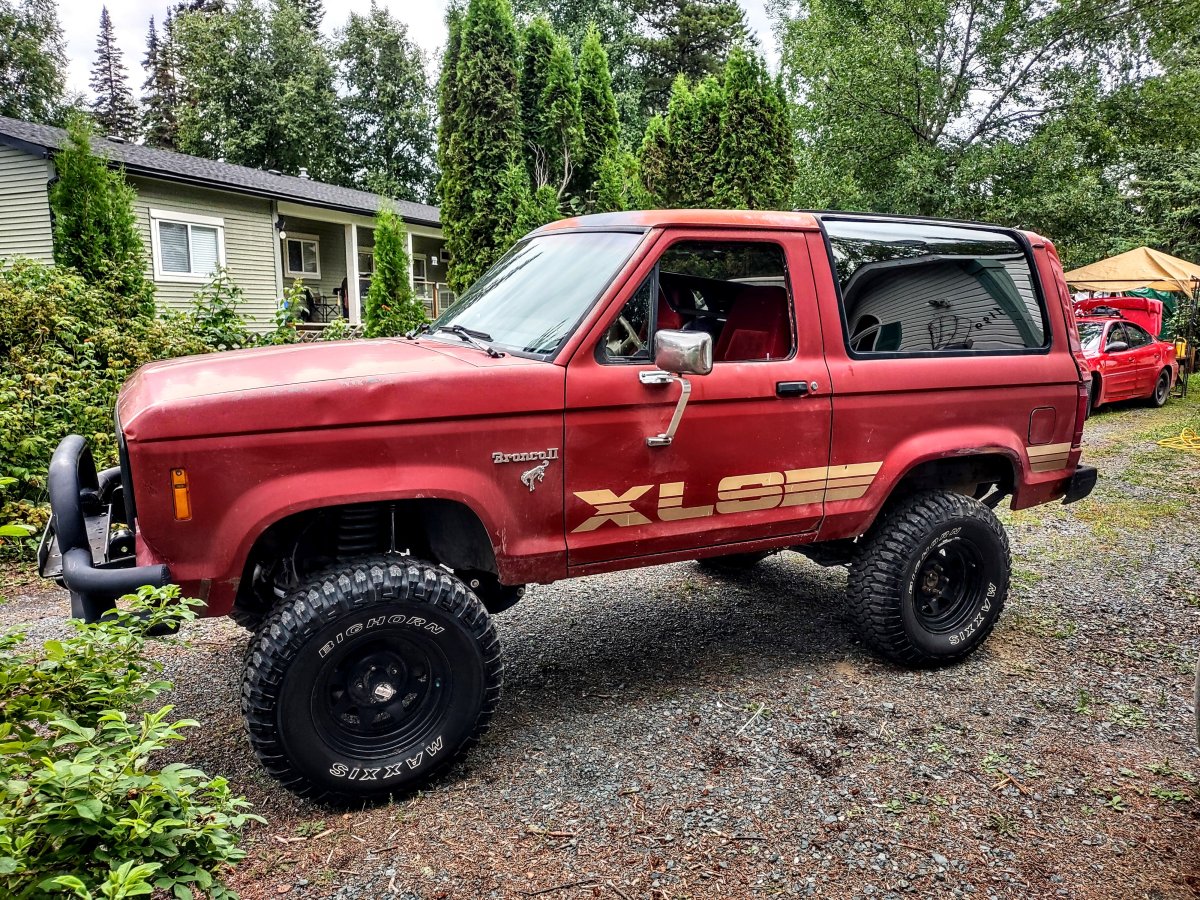

So I have been looking for a decent rig to build. Finally I found it. A rust free, solid frame, 1984 XLS Bronco II. It's got a fresh Rough Country 4" lift, new 31x10.5 mid tires and Pro Comp rims. A really decent 8/10 interior and a V6 that smokes a bit and leaks oil. Limited Slip Rear Dif. I took it on its maiden voyage 2 days ago and after about 12km, the front end seized up on me and I had to park it in the Walmart parking lot. By the next day I had all the parts and tools to swap out the calipers and pads and it's like a Ferrari now.

I actually really like this rig. If I could change one thing it would be more tire poke to give it a bit more stability. When lifting a rig, I always like to get rims with enough backspacing that the stance is just a few inches wider than stock. As long as the tires won't rub. And I could probably go with 33s instead of 31s and not be too worried about breaking axles.

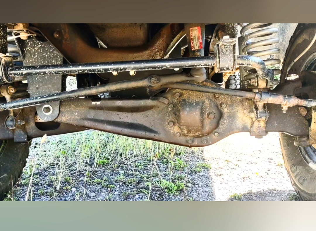

Hey so with the Dana 35 swap, what's involved? Are the scissor beams (or whatever they're called) staying in the truck and then just swap out the pumpkin and the axles? Or do you just move an entire new assembly over?
I haven't really looked to closely yet, but I wonder if the bolt pattern on the dif cover is specific to the scissor beam.

Nope, pretty much everything gets replaced.
