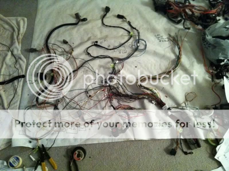

Its an 1999 explorer harness. Book I have tells me it is a tack wire. I will be using a T5 transmission. Will the wiring harness I have going to the current (4 cylinder 5 speed) transmission work with the explorer harness??
I overlooked the fact that things can change in later years... the earlier Eplorer/Ranger stuff had the tach in ECU pin 48, connector pin 2, but that's of no consequence if yours is different!
I would just check from the main 42 pin connector of the Ex engine harness. Use a meter, connect the trans harness to the big connector, and check the continuity to find the (and verify) that the VSS signal is in the correct spots, same location as your Ranger. And also the reverse lights. You can certainly cut up the Ranger trans harness as necessary. I would GUESS it is correct as is...
Feel my pain. Actually, not really as bad as it seems.... Yes, it was pin #48 for the tach.

You call that a mess?!
Here it goes.....

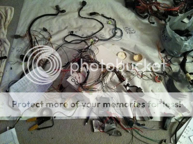

Big mess of soldering...

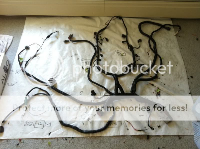

lol, that's why I included the finished product!
It's impossible to do it wrong, as you simply test the circuit with a meter as you go.
Yours should be must simpler, good luck!
