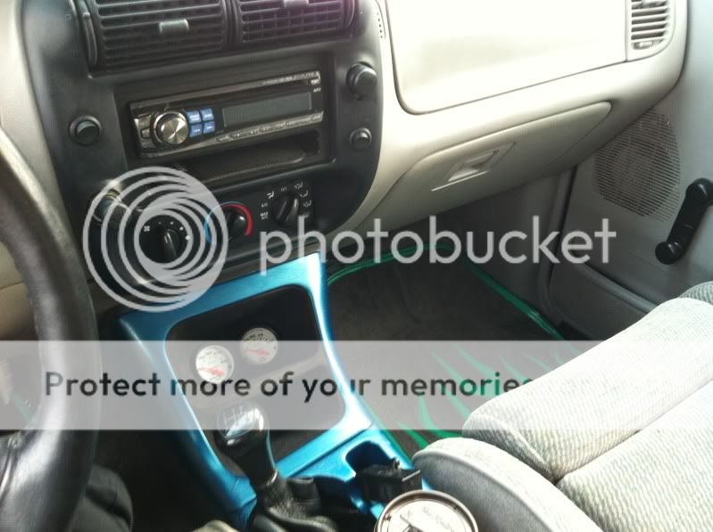

Here is the shifter location. Mustang mounts, T5. The original hole has already been filled, but you can see the patch.

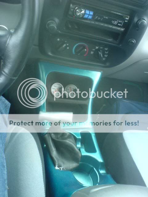

With Explorer console:

That location looks pretty doable to me. Looks like a mustang shift with a little extra contour to it?? I have the 60/40 seat, but think this will work.
My sift lever is the Mustang handle, but I straightened it.
Tried the Pro5.0 lever backwards when I swapped the shifter, but I prefer my straight one.
