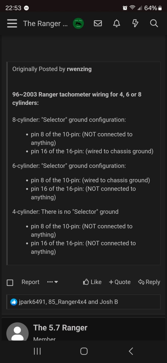

Josh beat me to it. Here is some more info from an old thread.
Since yours was originally a 2.3L the info in @Curious Hound's link might be more accurate. According it it you may not have a wire to relocate and need to add one. First time I've seen that information, but I've never had reason to pay much attention to 4 cylinder specifics.
Im still confused what do I need to swap or add considering that I have an i4? @Curious Hound
It appears that you will need to add a ground wire to one of the connectors on the back of your instrument cluster. On the 16 pin connector, you will need to add a wire from pin 16 to ground, if I'm reading this table correctly.
