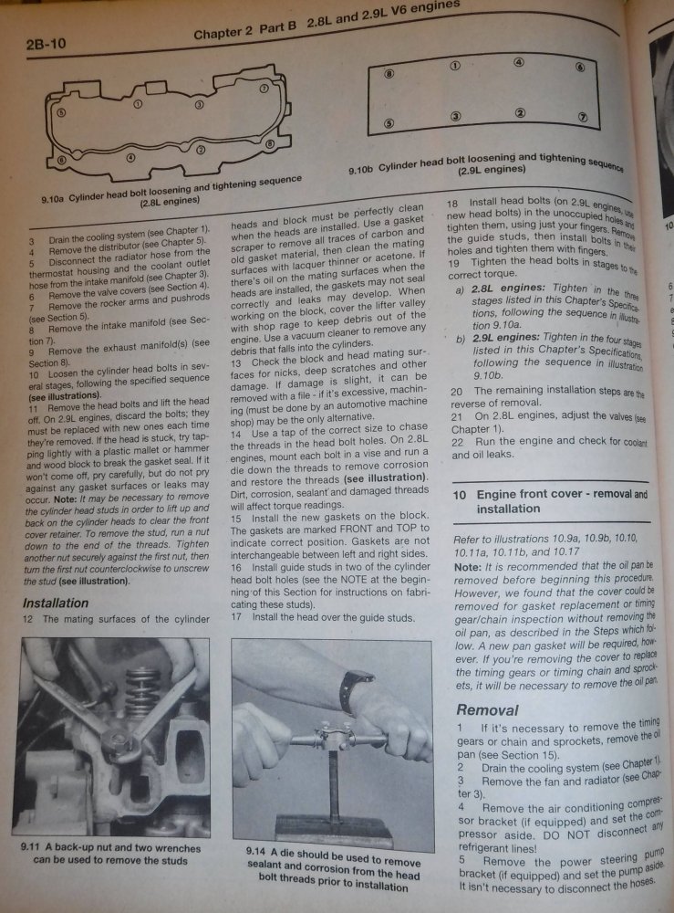

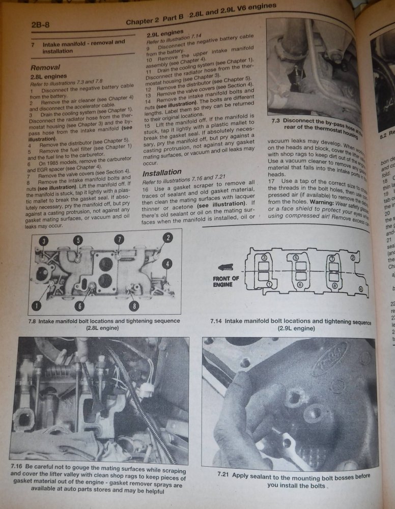

This is from an old 83-92 Haynes Ranger and Bronco II
THANK YOU!!!!! Its sad how the new ones dont have this level of detail anymore.
I hope it works for ya Max
