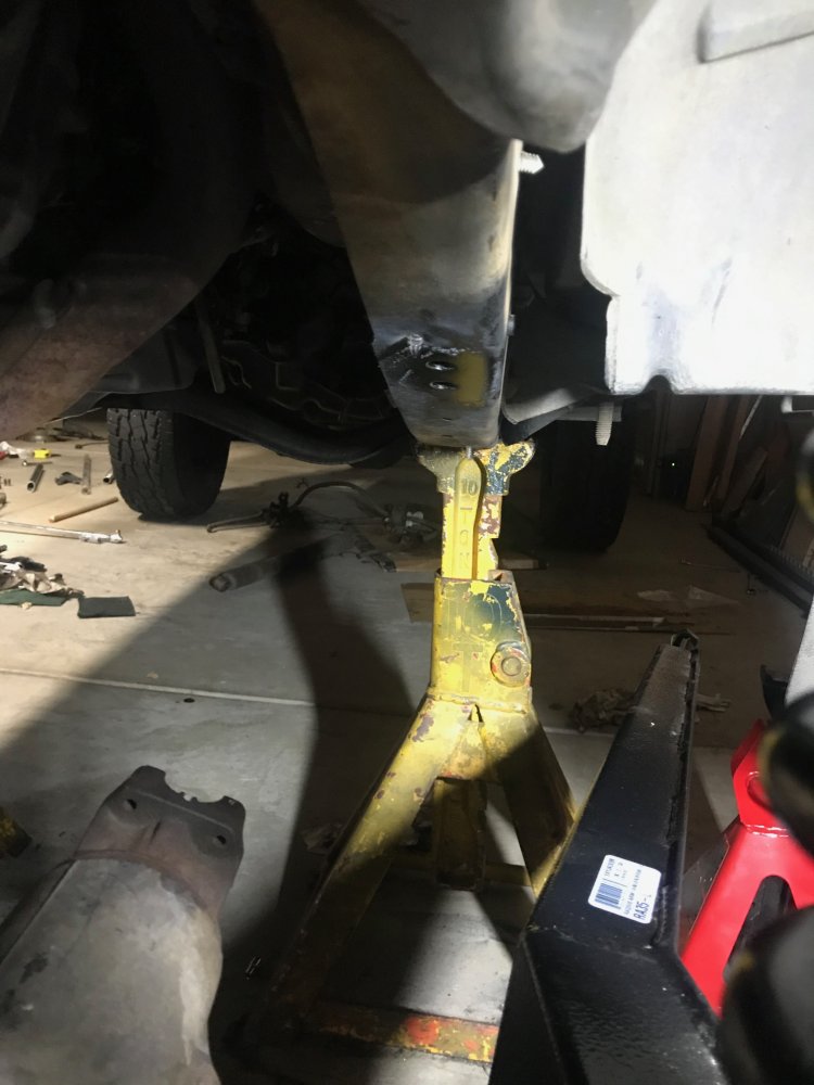

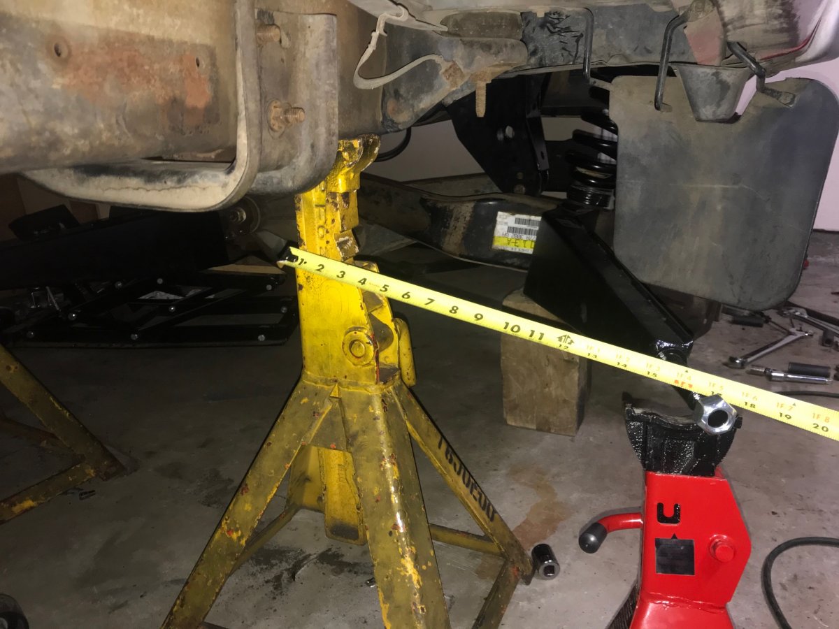

Hey all, im sorry to start another thread, but i finally got the SJ class 2 lift kit and the radius arms, got the drop brackets installed and radius arms onthe axles, but now when im trying to put the coils in, they dont really want to stay in after i twist them in to the buckets will this be way better with all the weight on them?, and the big thing is my radius arms look way out of wack and point way outside of the frame, the left one points about 9" outside the frame and the right side points 17" out of the frame!! When i try to push them towards where the mounting brackets would be they just want to bend the axles aft and that doesnt seem right either. the Arm with the R on the tag is on the right side and the L on the left Am i doing something wrong? or do you just have to muscle them into place? It really doesnt seem right doing that? i just feel like something isnt right. bellow are some pictures, mostly of the right side but 1 or 2 of the left, i really thought this was going to be easier than this, this kit is kicking my ass and im just ready to be done with it and driving the truck again.
Thank in advance fro any help

Your Radius arms don't swing in towards the frame since they pivot at the axle? maybe loosen them at the axle and swing them in and tighten once lined up.
I have not installed aftermarket arms....
I would install the coils last with the proper tool. Loosen the bolts at the axles and swing the arms in. You may have to install the arm into the frame brackets first then swing the arms in to install the axle bolts.

The arms will swing in after you loosen the bolts holding the radius arm to the beam. Once you have the ends in the brackets, then torque down the bolts on the axle.
Don't tighten the bolts that hold the radius arm to the axle beams until everything is together. Don't tighten the pivot bolts in the drop brackets either. Which hole did you use on the drop brackets? Should be the top one.

On mine, I had to grind off part of a lip on the driver side axle beam in order for the radius arm to swing completely into place. I think I put photos in my build thread and there is reference to it in a tech article somewhere here on this site.
Thank you guys, I will go ahead and work on re doing all that, at least the axles are back in and hanging, I did grind some of that lip down because I saw that it looked like it would interfere, but I may need more, ill check when I get home. I really do appreciate the input because I feel I am a pretty decent mechanic but doing this lift by myself is kicking my ass. Hopefully I can just get away with loosening the arms and not having to fully remove them.
Mr. Jim oaks, I had read your install a few times and know that you moved yours to the upper hole, do you think I should still try the top hole first since I am adding 1" of washers under it, I am anticipating my lift being at about 5.5 " up front. and BTW your 1996 TRS build I loved.

No way to know what's best till your close
With what your saying starting with the 4 in holes is prudent.
You always put it together loose and get it on its weight before final torque....loose meaning moveable with some effort not barely together of course.
On weight. If it's close enough for dial in snug the arm lowers then jack it up to unload and put the final torque to it
Even with the 1" of washers the 4" hole should work. I am using the 4" hole(superlift brackets) with my Skyjacker 6" coils, and my truck is lighter than yours.
