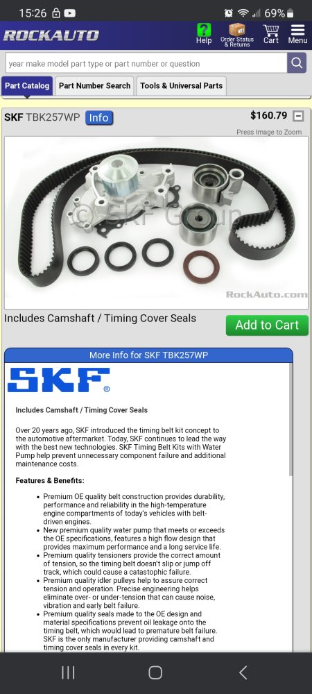

A timing belt kit will generally include the belt plus its pulleys. Then you get to decide what else you want to add into the plan, e.g. water pump, etc. Anything that is either obviously ready for maintenance and easily accessible while you're there.
As linked above, you can also buy kits that include the pump in the mix.

Yes. It does. You want a kit like this. Once you actually start shopping, you see what parts and kits are available. Then it makes sense. For common jobs like this, the manufacturers sell kits with all the most commonly used parts for that job.
OK thanks that is WAY cheaper than local I mean a LOT. I was in big rush so looking local, but she says her next trip is 2 weeks away, that gives me option go Rockauto, I've had good luck with them.

I recommend that you buy the kit that includes the hydraulic tensioner like this one:
AISIN TKT024 Instant $10 Off Manufacturer Rebate!

Well, I couldn't get RA to bring it up. I don't see it in their list of same stuff and it didn't come up under a part search.
Here's the thing the $170 says "premium quality tensioners" vs specifically hydraulic (which the expensive one is).

I know it's the same they listed that's why I looked for it. The link they put is to a coupon I am showing the actual part available.
Basically I'm saying if rubydist says this is oem and better than that's the one I'm getting.

Question of which water pump kit is still open I guess - see what rubydist says - I'm not looking to waste money but if it's actually a different (and better) tensioner and is oem then I'm getting that.

It's literally the same Aisin TKT024 part at all three sources.
On the Rockauto listing (filtered by your 2002 RX300), it's near the end of the list.
