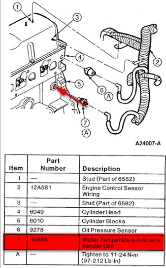

okay my truck does not seem to have a connector for the coolant temp sender. not the sensor but the sender itself that sits towards the back right side of the block. i've checked just about every part of the harness and all it has is the connector for the oil pressure sender but no connector for the coolant temp. or maybe it's the oil temp connector that i'm seeing. either way i'm missing a connector. anyone know the specific location of both of them?
there's only one sender plug coming out of the harness in my truck. where in that pic there's two. maybe it's different for 97's? this motor was supposedly swapped in but no idea what year it came out of.
