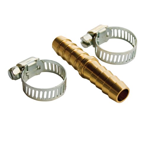

Why couldn't you just buy some hose from an auto parts store and use these to splice it into the existing hose for your gauge and make it longer.
You could make it as long as you want that way. Shouldn't cost more than ten bucks total.
I'm trying to keep that idea as a last resort just because I don't want to cut into the hose.

I'd still just hack up the one you've got...but that's me being cheap :)
I'm not looking at it from a perspective of cheap. I'm a pro and need at least once working fuel pressure gauge. If I hack into mine and it doesn't work anymore.....
well then I'm still stuck buying another new one.

A valid point, but I've patched our 150psi power sprayer systems at work with them before though...never had any big problems doing it. I think you'd be fine doing it with a fuel pressure gauge.
I understand if you're squeemish though. All my patching was done on a system that was already broken so I had nothing to lose.
