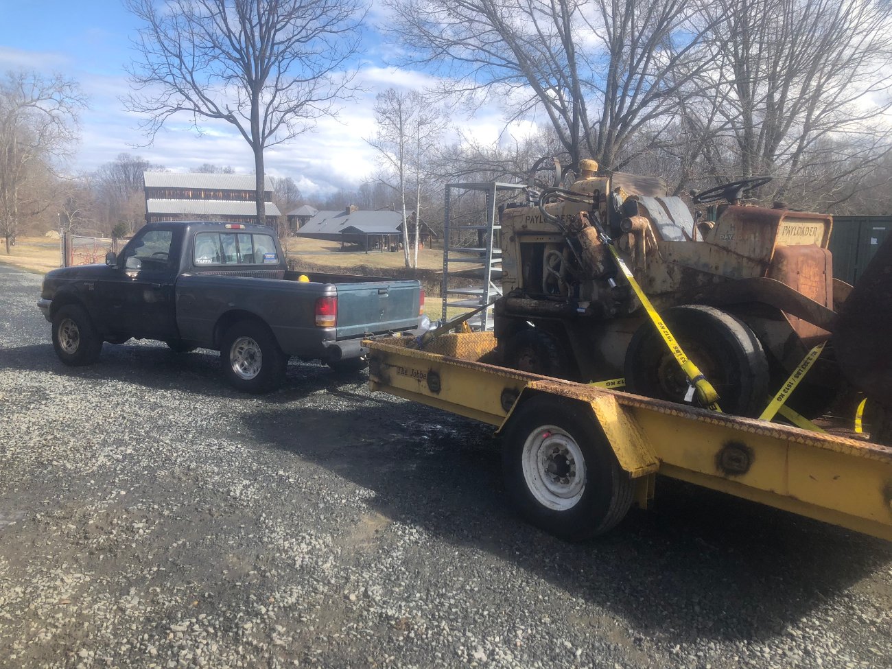

Here's the heaviest thing I've got a weight slip for. Truck with me in it is ~3500. Didn't fit on the scale so the "steer axle" is the whole truck.

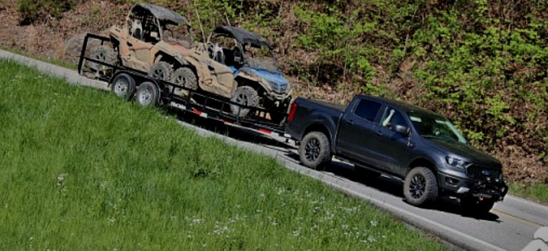

Mine was bought to be a tow rig. Thats before I discovered how capable the Ranger was haha. But it used to tow 2 SXSs on a 20' dovetail trailer. Each weighted around 1300 lbs before the bigger tires and upgrades. Probably closer to 1500 lbs each. Never skipped a beat through the all the hills and stuff on the east coast. I do have the RedArc trailer brake kit. Ended up doing an extra leaf to keep it from sagging after the level kit was installed.

If you're gonna going to lick the boot at least know the law. This trailer is rated for 8k. I can make this load legal simply by moving the loader aft in the trailer. Ain't no different than a semi truck sliding the 5th wheel or the tandems.

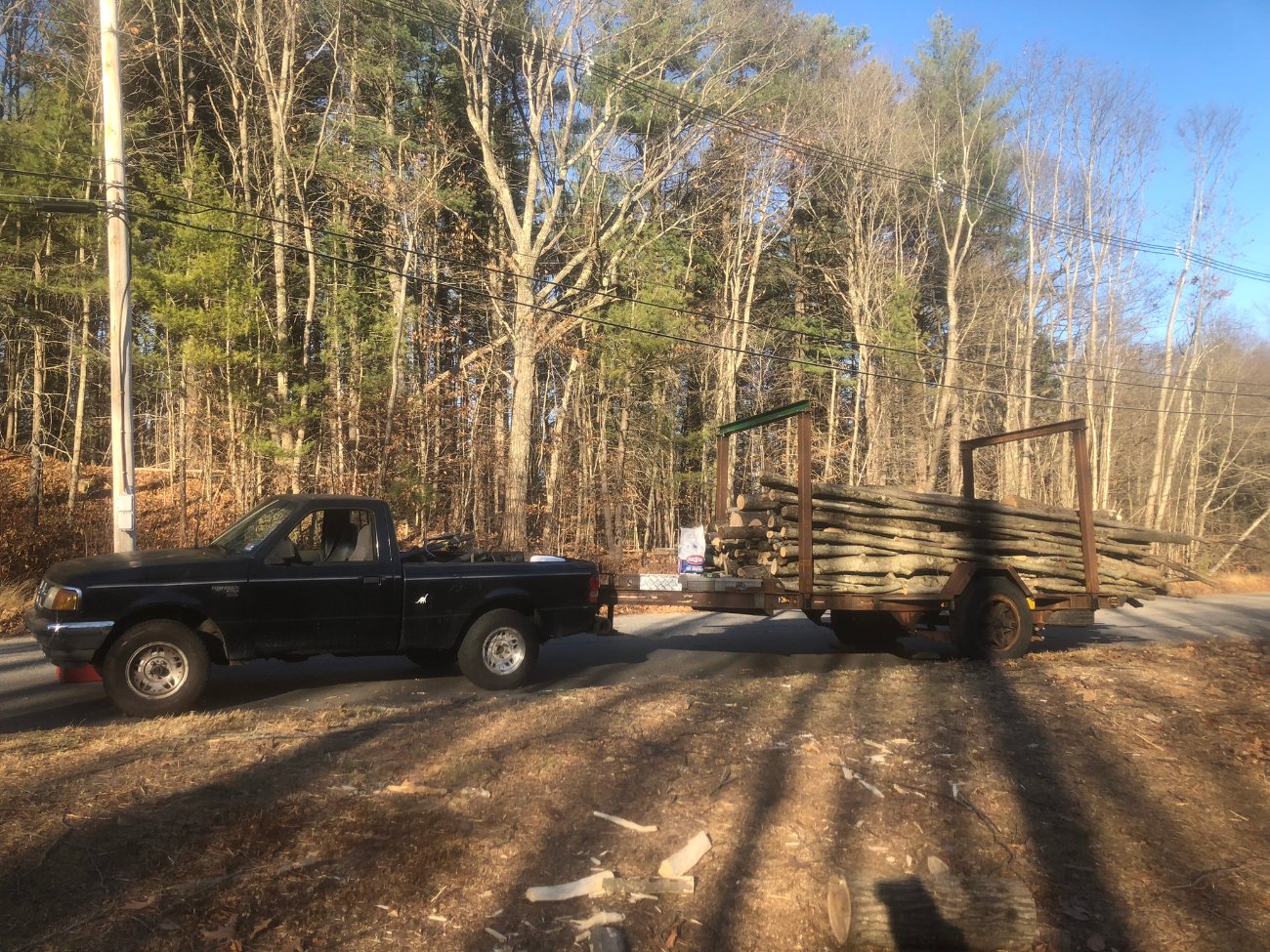

Speaking of monumentally less safe, here's an example of exactly that sort of problem. Trailer deck is 14ft long and a couple inches over 6ft wide and there isn't much pine in the mix. Someone else can calculate what it weighs but it's not a little. That's an 8.00R20 tire on the trailer for scale. I only had to go across town though so tractor speeds were fine.
