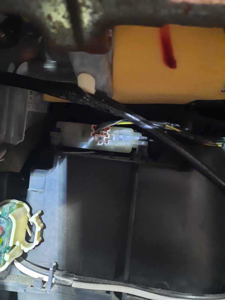

It does have the electronic blend door actuator.
I have seen videos on cleaning these things maybe a clean could fix the issue?
they pop gear ect....fairly cheap and usually not a total horror show to replace.....but sometimes...ewwwww
i have had to pull straws and pens out as culprits dropping down from the defrost duct on the dash quite a few times... especially in the fullsize gms that were jammin up the doors.
I see the screws holding the actuator at the rear are difficult to get at. This thing is now blowing cold through the vents, the problem comes n goes.

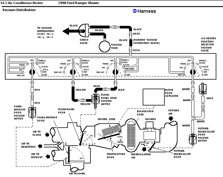

As a side note I don't see why it would be the blend door since that should not affect where the airs final destination is actually going, just the mixture of the air. Here is a schematic I only spent two minutes looking at it, but it should tell you most or all you need to know about the system.
Funny thing is I have had to deal with this or a similar issue on all five Rangers I have owned. Smoke testing is typically the fastest check.
