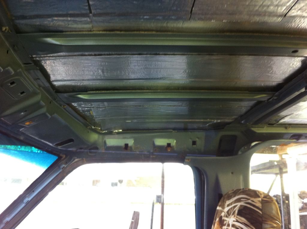

As I continue to get my 89 B2 up to the way I want it, I decided to do something about the hollow tin can sound when closing the doors or rear hatch. Pulled the old headliner, added sound deadening material, and will be replacing the headliner in the next few days.

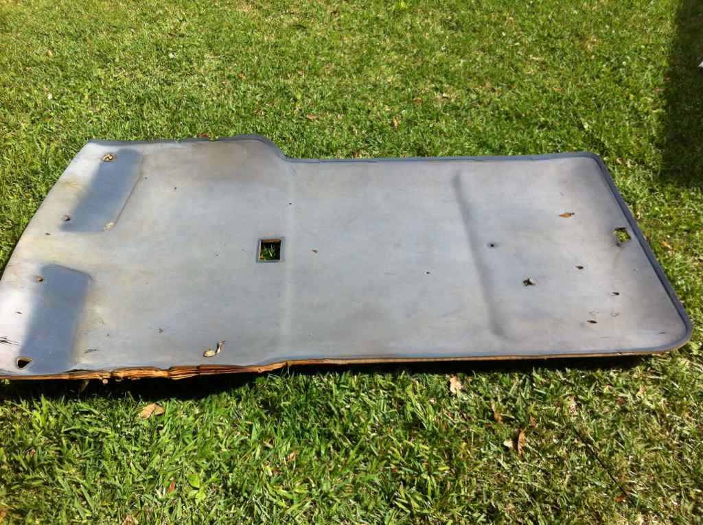

Pulling the old one out was easy. But I found that the board is shot. So I'm going to fiberglass the board I have, and mount the new material to the "new" fiberglass headliner board. Here are some of the pics so far. I'll have more later this weekend.
Old liner out
Headliner replacement with pics

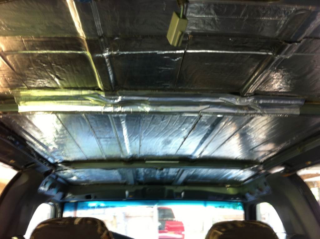

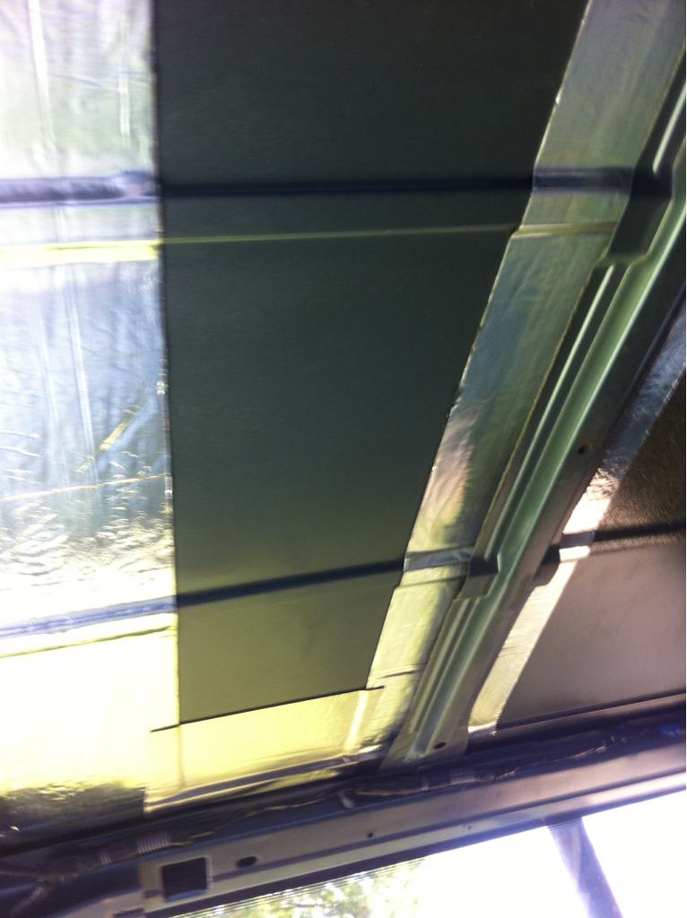

Sound deadening material going in
My headliner was a mess from mice, I used hot glue sticks to repair all the cracks, filled in some holes with 1/4" styrofoam, then recovered it with a very lightwieght fleece with bears all over it, that was 4-5 yrs ago and no issues.
Fiberglass might be too heavy and difficult to tuck in the edges, and you cant put fiberglass directly onto the original liner, it will disolve on contact.
Not sure what you mean about tucking the edges?
But I can promise you that putting fiberglass on the original board will not dissolve it. The first layer of glass is drying in my shed right now. Tomorrow, weather permitting I'll get another layer of resin on it and then I'll flip it over and scrape the old foam off the fiberglass template. One more layer of resin on that side and it'll be ready for the new material to be glued on. I'll post more pics tomorrow.

That is awesome work! I like the solid attention to detail with the sound deadening material (something I plan to do to the sides and top of mine one day).
