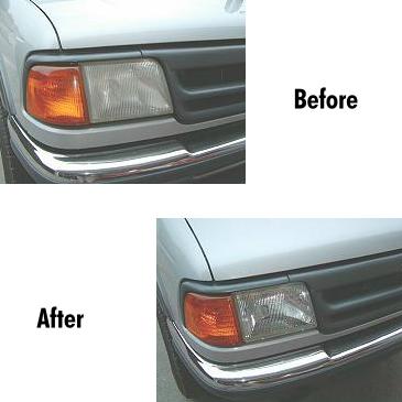

One other thing I did was read the tech articles on cleaning/de-fog/de-haze your plastic headlights here and the threads I found here on clear coat painting your lenses to stop it from happening again.
If I can throw this out, the clean/de-fog/de-haze pics here on TRS looked very promising.
edit, add link:
I am/was very skeptical on the clear coating, until I read the back of the clear coat I got for the body - it says UV resistant, can be applied over non-UV resistant paint to add UV resistance.
sooo.. I am thinking I am going to meguire's headlight cleaner (it's pricey), then shoot some clear coat on em.
