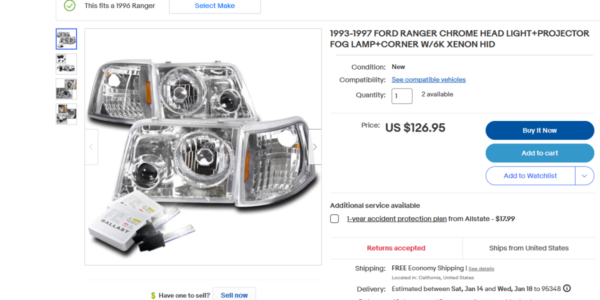

Should be no problem then. As was said above, you do need proper housings for HID bulbs, but having that, they can be pretty bad-ass. Higher °K numbers aren't quite as glaring with HID as with LED, but I would still suggest something around 4000-4500°K for best light quality.

I had a 92 that took the 9004, I used the ones with the blue bulbs because they were brighter, but they didn't last as long as the standard ones. Did you price just the HID bulbs? The standard HID bulbs are almost $100 just for the bulbs, and that doesn't include the different housing they require. In my 04 Ranger I have higher wattage bulbs; standard is 55-65 wats and I have 80-100 wats. They aren't considered legal but around here most of the newer vehicles have LEDs and mine aren't as bright as those. I have one of those small light bars that has the LED lights in it, and it is bright, but it doesn't light up very far in front of my truck, maybe some of the new one do, I don't know.

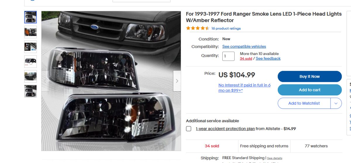

I imagine something like this is not actually made to support the use of LED bulbs and is simply advertising the built in vanity LEDs ?
