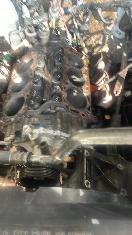

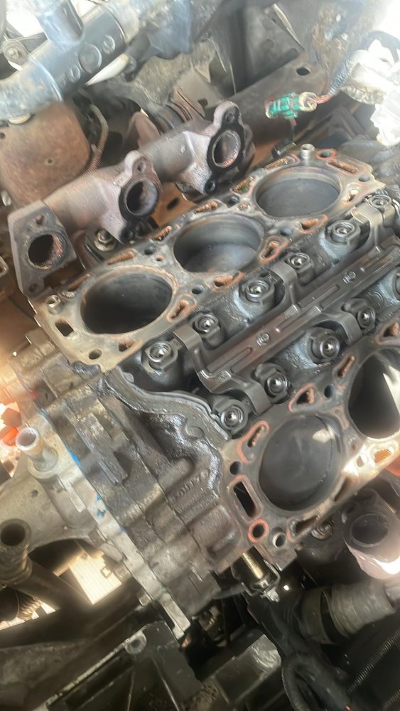

we have removed everything to replace the head gasket we took in the heads and they are shot so my question is how do we check the lower part of the engine to make sure it's OK to put brand new heads on?

At minimum, a close visual inspection of the cylinder bores for scratching or galling.
With the motor still of the in the chassis, doing a visual inspection, and measuring with a mic or plastigage if suspect, of a few of the bearings would be difficult. Without pulling the block and further disassembly, if the cylinder bores look OK, and the truck didn't use a lot of oil or have any knocking sounds before, I'd just put the heads on see how it does afterward.

Without the motor assembled with the head on & sealed as is, you still need to test the compression, & check the oil pressure, along with the visual inspections mentioned above. It would not be a waste of time to re-install the head with a new head gasket after the valves and valve guides are serviced, & the head milled for flatness and check that oil pressure that should of been done before disassembly. There is a trick.....to test by adding oil into the spark hole looking at a compression gauge. 1) check the compression, 2) next add a tsp of oil and take note of any added compression reading. The addition of oil tell you that the piston rings are worn. You also have the valve and valve stem seals that will also leak after so many miles.

I'm sorry, but I wouldn't feel confident in that engine block if coolant got into the oil and it was run for any amount of time.
Before going to the trouble (and expense) of bolting on new heads, new gaskets and bolts, I'd want to pull the motor, remove the oil pan and crank and rod caps and check all of the bearings.
At this point, even though it's a bitter pill, if it were me, I'd look around and price a reman short block to use those heads on.
Others here may have better suggestions, though.

Soooo . . . if the bores look good, and you're sure that coolant didn't contaminate the oil, it's worth taking the chance on putting the heads on, and seeing if you have a serviceable engine.
The overflow gurgling is a sign of cracked heads or a blown head gasket; that should clear up if the head installation is successful.
