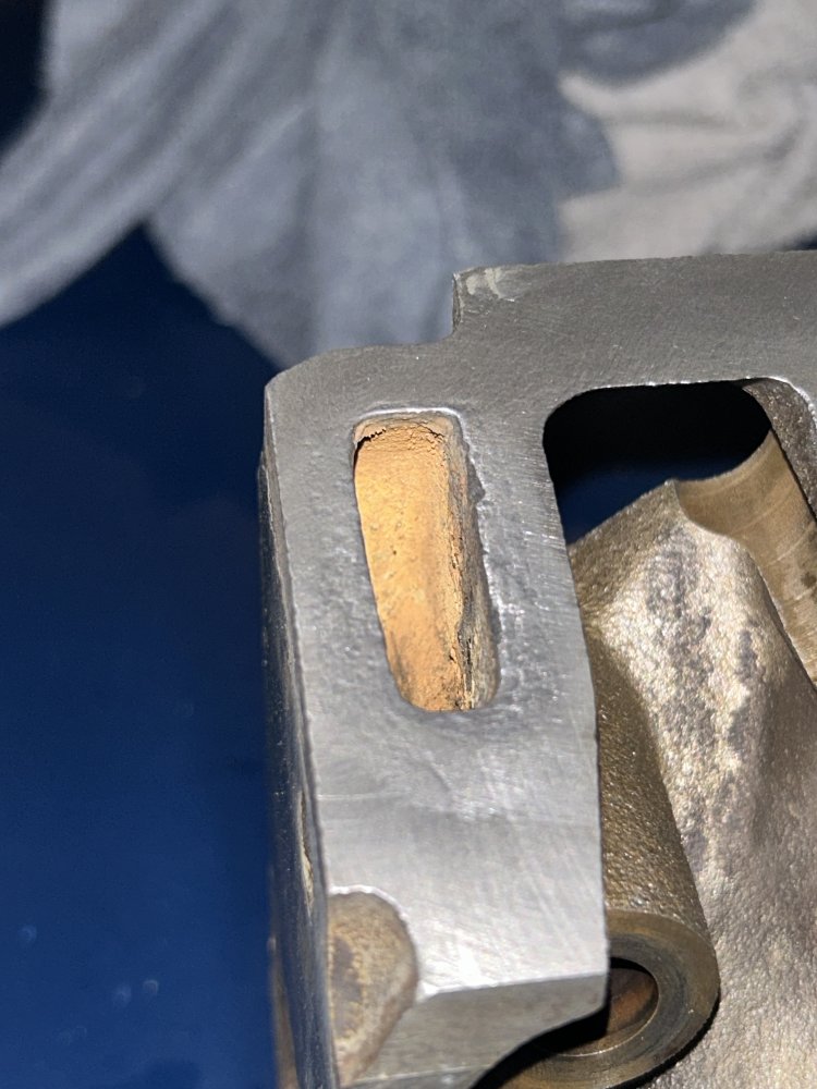

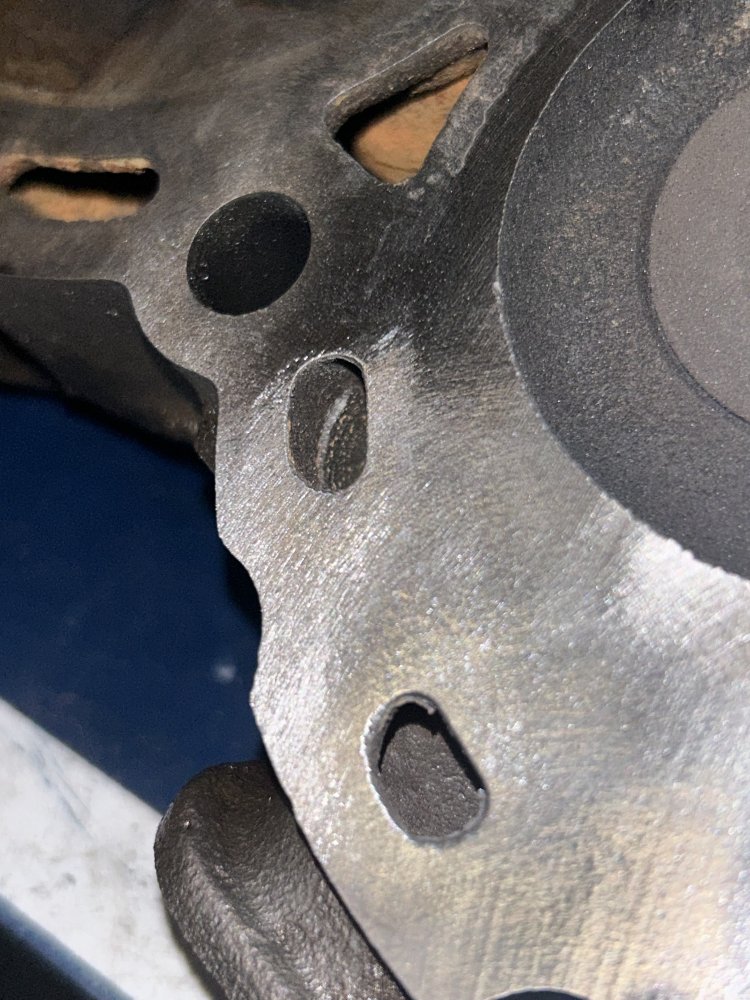

Resurface or run it?

No expert, but my 2 cent. First pic, I'd be concerned about sealing around that water jacket, it looks rough and pitted. Second pic, I don't see anything I'd be very concerned about. It's difficult to really tell anything through a computer screen.
I would probably resurface based on the first pic, but someone else might say to just apply a liberal coat of sealant.

I'd get it surfaced.
What's a machine shop cost to skim a couple heads these days in the USA? (I honestly have no idea). My method would be to weigh that cost vs the cost and trouble of having to do the job again
On a lot of jobs I'd probably push my luck a little bit but heads probably aren't something you want to have to do again soon right?
On my little phone screen it looks problematic. I'd probably still run it because I'm cheap and like to live on the edge. :LOL: (And yeahI don't think a gasket alone is going to seal that, you might have to get creative with some sealant if you were to run it)

based on the pics....i would run it.

I wouldn't worry about that coolant port. Still plenty of meat left. (You can see where the original gasket sealed.) Now the general roughness concerns me. My heads were almost as smooth as glass when they were put back on. Were they cleaned with a wire wheel?
Agreed w/ Snoob. The gasket will form fit to a point ...and I can see how the might be a benefit,. But mine were smooth when I did mine. I got pics but I'm on my phone.
