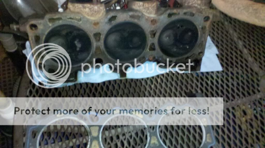

here is one side, notice all of the coolant ports are plugged? I also cleaned the heads after these pics were taken.

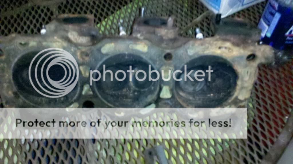

this is the driver side there was alot of crap in the back cylinder, u can see it, its on the right.

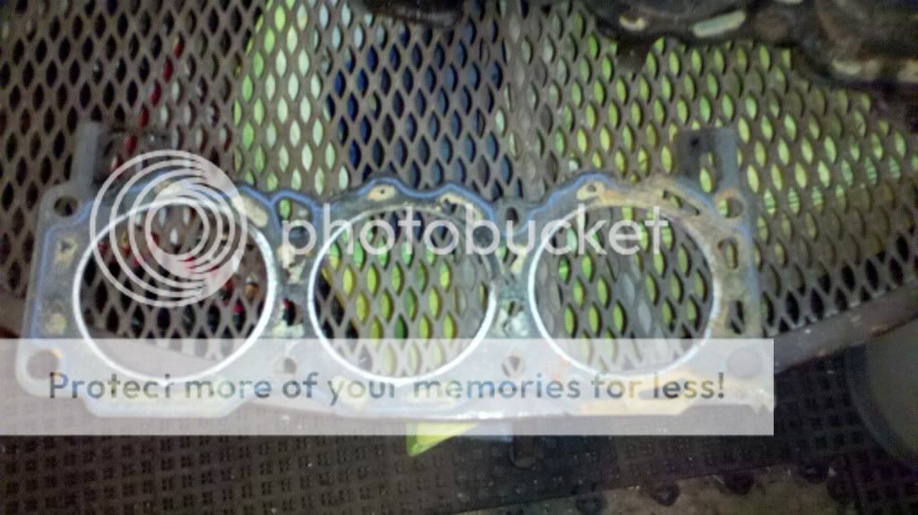

and this is the head gasket for the driver side, all coolant ports nearly plugged.

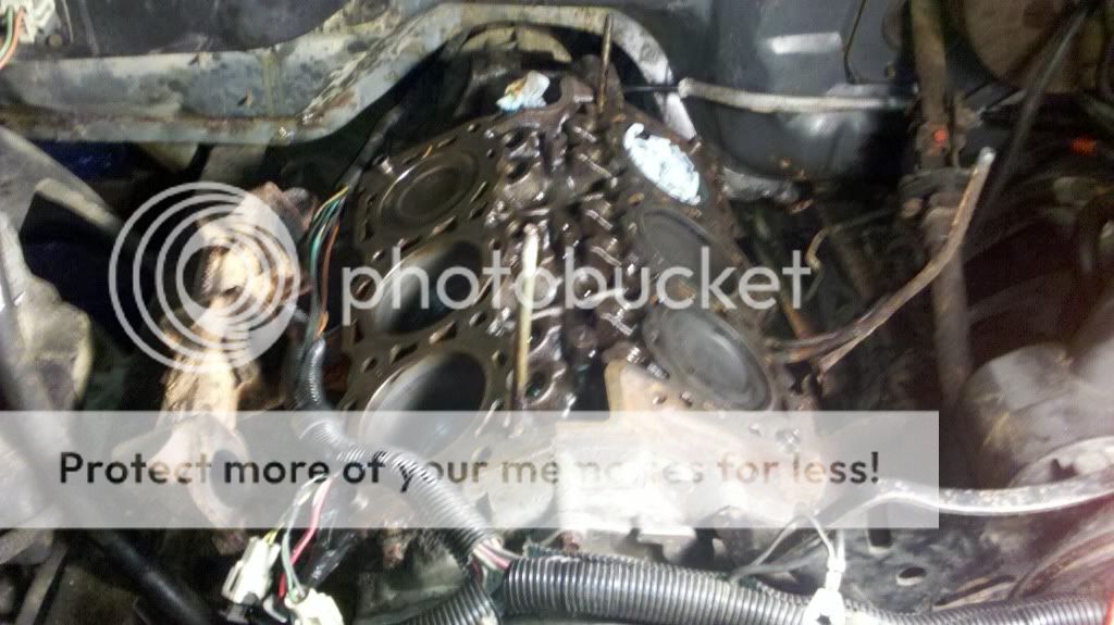

and finally here is my block I cleaned it all up, just thought id throught it in as well
