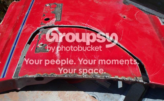

Test fit - cut a little oversized
Welding
NOTE: I can weld, BUT I am limited by the equipment I have to work with. Here is my Flux Core Mig by Century. I am just trying to go slow with it and do tacks not long beads.
Temp fitted into practice fender:
Side view - not too bad
The back side - I know the welds look bad - wish I had a gas shielded mig.
So there is one side fabricated, I need to clean it up, add filler, make sure the vent will stay in place securely and prime everything.
Once both vent mounts are fabbed then I will cut the mounts out square and graft them into my stock fenders on the truck. I may even pull the fenders to mount the vent mounts so I can work it from behind too.
So what do you all think so far.

Even trying to go with small spot tacks, sometimes I get the balls or miss the joint or melt the thin metal. Wish I could convert this to argon, but I cannot.

you can actually get flux cored welds to look decent. its a matter of slowing the wire speed down to let the weld melt in instead of balling up on the metal.
but yeah. i love my lincoln 110 mig and my airco 220 mig. both on gas.
dont forget. pure argon is for aluminum and stainless.
steel is 80% argon 20% co2
SEE just goes to show what I really know about it. I learned on stick in high school and that was a long long time ago - the school did not have MIG back then that I knew of - we also oxy/acetylene welded . . .
Thanks man for the info - I only have four possible selections on my welder, going to have to play around with it some.

My welder is gas ready and has all the parts, I just need to come up with the $200 for a cylinder and a fill. It's not too high on my priorities list since I've only had to use the welder twice...
That is cool that you can convert. I have to find a better welder if I am going to get any better at this stuff. This is the welder that has done ALL of the welds on my Ranger so far. SO you see there have been no major structural changes.

go get a lincoln 125, it'll do 22 gauge (i think) up to 1/4" steel. you can set it up for gas, aluminum and stainless too. plus it plugs into a wall outlet, so there's no need to call an eletrician. i've had mine for a few months now, i love it. it was only $400ish too, so it wont break the bank.

I've got an Auto Arc 130. Its a rebadged Hobart Handler 125 and came with a cart and regulator. It was about $320 and it's all set for gas.
I have had excellent results with Blue Demon flux core wire. I have the HF flux core welder and I have it set pretty good and that wire has less slpatter than what came with the welder.
I have the Small CH welder from Tractor Supply, it does great for me, and I welded all the body panels on a 67 mustang with it, I'm also using their brand flux core wire, just turn it all the way down and turn the wire to the slowest possible setting on mine the level 1 does great.
