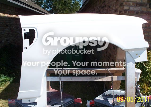

Back on topic . . . got the vents mounted and flushed in the fender section I got from WNY964X4. Just a few pics . . . note the ones on my truck are photoshopped.
Now do I graft these in or do the mod on the fenders?

I'd do the mod on the fenders, seems like it'd be less work.
I would just do it to the fenders ... lot less work..
Thanks guys - pulling the passenger fender today . . . going to do it!

Will be remounting the fender once it cures, then I will get some final pics.

tom i wont deny it looks awesome. BUT. you need to get away from using "RED LEAD"
it will shrink once the sun hits it. and its not a stable. you need to try this stuff called icing. http://www.autobodytoolmart.com/usc-icing-polyester-finishing-putty-p-10969.aspx
you mix this stuff like normal body filler. and its so much better. you can use this right over bare metal.
give it a try
I know - I was out of my Metal Glaze by Evercoat - I love that stuff and it is a holiday so no where to get it.
