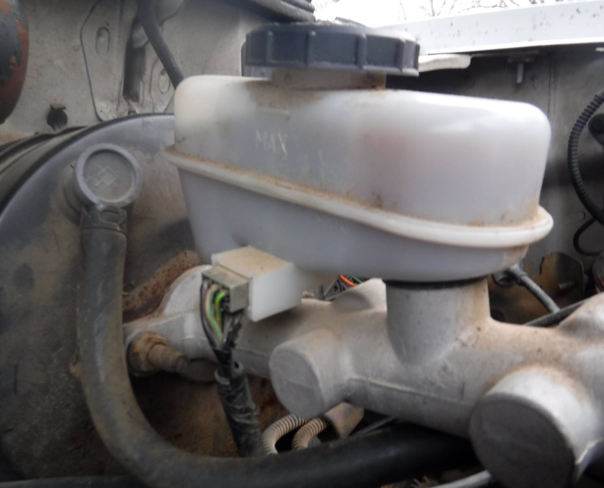

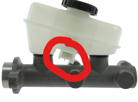

Can someone tell me what is supposed to plug into this on the brake master?
Low fluid level sensor...
ok... so.... the one i have in the truck is the same shown above except original from the factory.... It doesnt have anything plugged into it? .... i know i may sounds like a blasted retard here but is something supposed to be plugged into it?
Yes... if it's functional

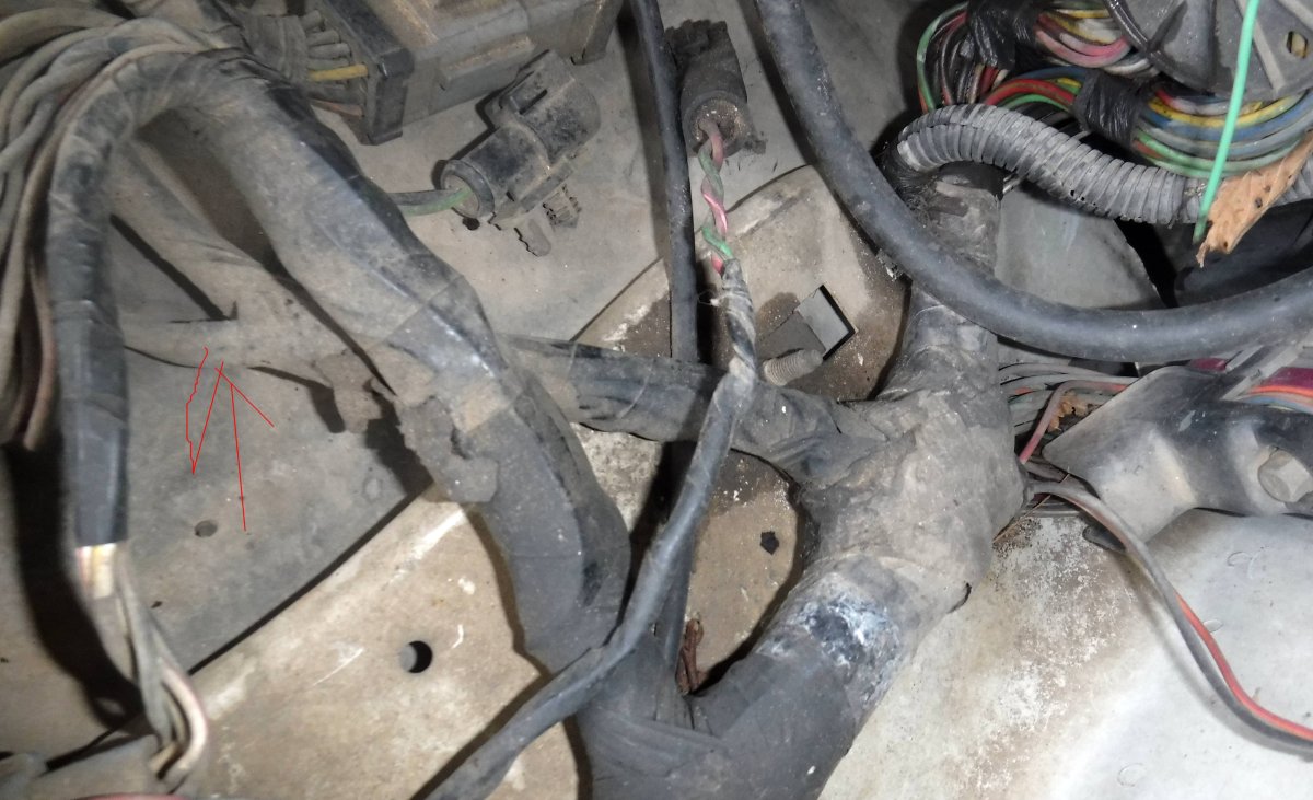

Ok so somewhere under the hood is the connector that plugs into this... I will get to searching. Z
Learn something new everyday.
Thanks Uncle Grump for the help..
Well... it may not be equipped.
It's possible that that particular master/reservoir fits more then that year... and some years have low fluid indicator.
