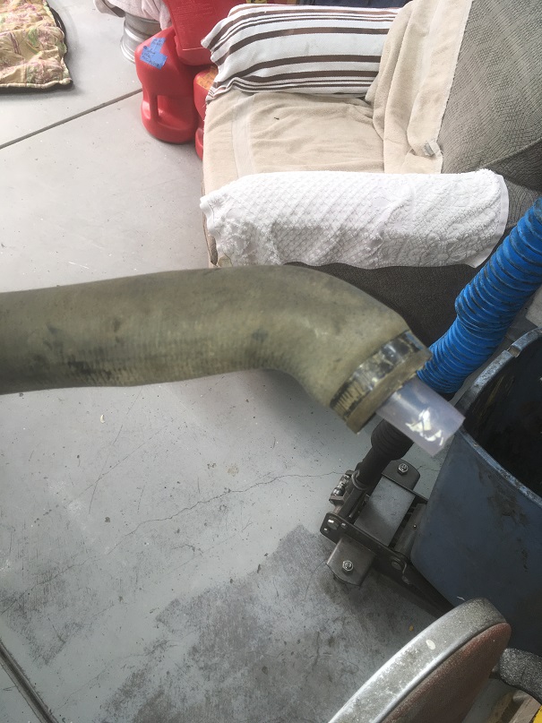

Bought this truck (86, standard cab, 2.9L) and whenever I try to fill the tank, I have to let it just dribble in or the pump cuts off.
When I first noticed, I pulled the fill neck off and noticed the inner tube was broken off about 2 inches from the metal inner end. So I bought some 1" vinyl tubing and extended that so it goes into the tank. Went to put some gas in and no change.

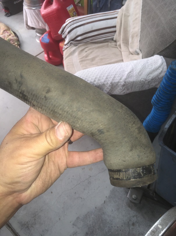

Pulled the fill neck again and noticed the neck gets scrunched right before it goes in the tank:

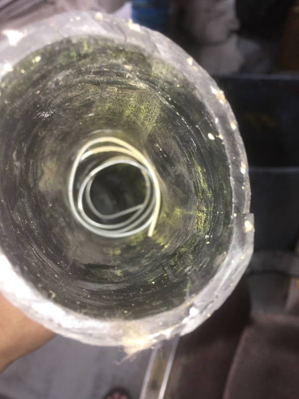

I took a length of old coat hanger and made an inner structure to hold it more round:
66325
It worked pretty well:

Went to pump more gas and same thing. GGgrrrrr....
What am I missing? Is the new vinyl hose too small? Does anyone make a new one of these?
The gas is backing up in the hose and/or the air in the tank can't get out the Vent, which causes the gas to back up

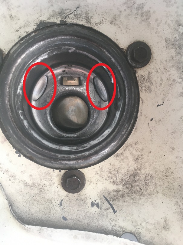

Step one, I looked at my vapor escape slots. This is what they looked like:
66464
I took a punch and hammer and bent them more open, like this:
66465

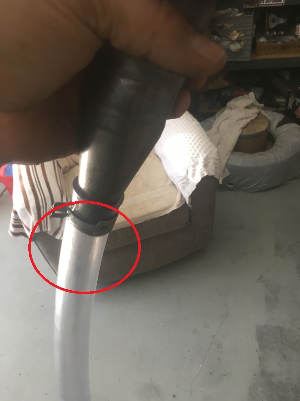

Poured gas down the throat and it immediately backed up again. Pulled the filler neck out and took it apart. I noticed the vinyl inner tube I installed was kinked where it meets the metal inner funnel dealie. I took that hose off and replaced it with another hose and used a heat gun to soften the vinyl a little to bend it. Threw it all back together and dumped 2 gallons in from a gas can without issue. Next morning, I went the gas station and put 3 more gallons in it without issue. BTW, it is MUCH easier to mess with this if you remove the 6 bolts that hold the bed down and tilt it upwards out of the way. That is waaaaaay easier than dropping the tank.
This is where it was kinked but this is the new hose installed.

2) take the neck off your truck. Separate the metal nozzle upper part from the outer hose and verify the inner hose is complete and goes all the way down into the tank. If it is not complete or does not go into the tank, replace the inner hose with another hose with 1" inner diameter (I had some vinyl hose laying around but fuel safe rubber would work too). Install it so there is no kink at either of the bends in the fill neck. Also, make an inner spring (I used an old coat hanger) to ensure the outer hose fill neck is round and not collapsing around the inner hose. Throw it all back together and try it out.
