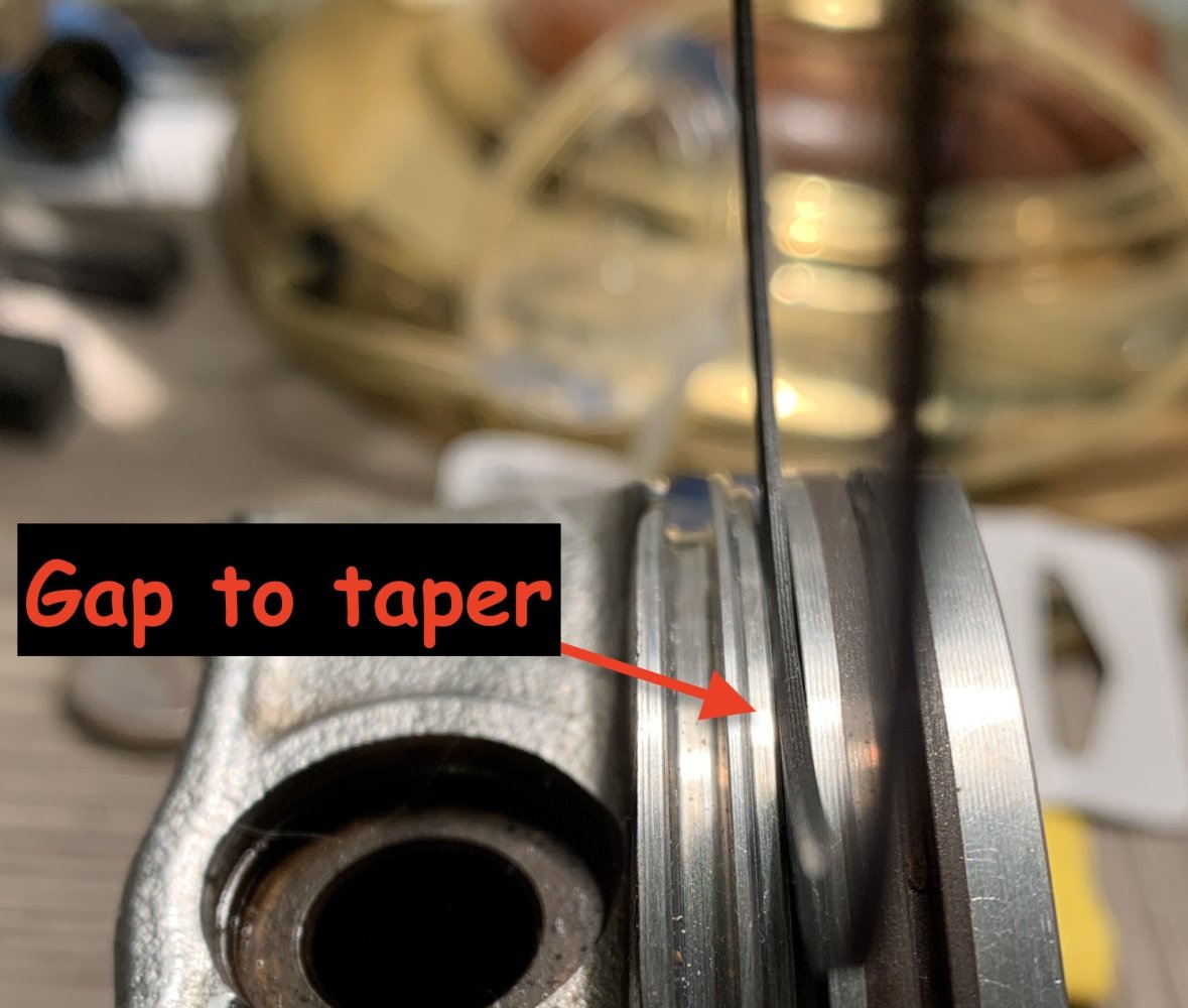

Assembling short block tomorrow. When checking the delivered piston rings for accurate measures I noticed this stepped slot in the second compression ring groove. When I pulled the engine apart I just discarded the old rings. I never noticed this "step" in the groove. I never recalled seeing this type of piston before. The second ring groove and second compression ring are correct for size but (why) would the bottom half be open? Just wondering.

What do the rings look like? Any kind of taper on the face that contacts the cylinder wall?
Thanks for your response. Interestingly- after I posted this question I placed the 2nd compression ring in the groove and inspected with a loop. The second ring tapers. So the top of the ring is just a few thousandths inside of the groove as it should be. The taper is a few thousandths inside of the stepped down groove as I suspect it probably should be also. I just can't understand why this was designed this way.

I think the ring flexes slightly allowing the face of the ring to scrap when going in a downward motion and slide over the oil in a upward motion. The groove allows the ring to flex more?
Edit; this is all just a WAG. Wild Ass Guess.

Thanks guys, did a little research. I think these are "Torsional Twist" rings. The bevel is designed to "flex" to that side for increased sealing. As a WAG "guess" I suspect the gap is to control gasses or blow by that get to that ring.
