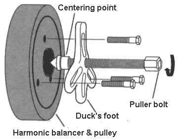

So, being one that does not like extra noises from the engine bay, I borrowed a puller set from advance to try and bend it back into shape and cannot get the darn thing off. I had enough pressure on the breaker bar to actually spin the back tires with the truck on jack stands. Also bent the the heads of the M8 puller bolts. Not cool!
This is the exact puller set up I was using, but with two bolts not three. Any words of wisdom? Thanks in advance. - Andrew

did you take the washer out with the bolt? I have done that before.... you need a mechanic's pick to pull the washer out, it could be rusted in there pretty good.
No! And thank you for the quick reply. Will try and report back.
Sure was a lot easier without that washer in the way. :rolleyes:
