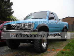

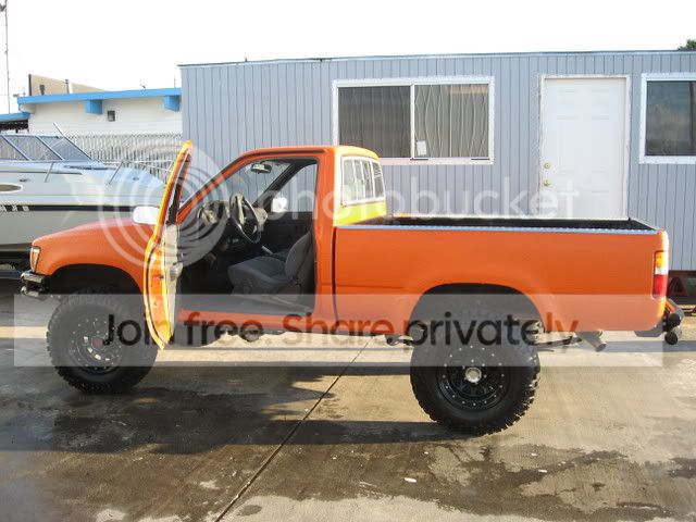

I've sprayed ALOT of the do it yourself stuff. Beds, rocker panels, Bronco tubs and seven complete exterior jobs. You truly get what you pay for. While the do it yourself stuff is OK, it doesnt hold a candle to professionally applied stuff like Line-X. All my trucks (that I care about) get Line-X, even though I could do it my self for much cheaper. It just holds up way better. Heres a couple pics of two completes I did, so you know I'm not talking out my ass.

Those were both sprayed by me. I used SEM truck bed liner with no acetone and sprayed it out of a standard Schutz undercoating gun.
