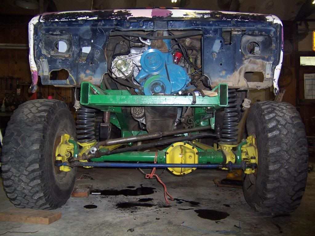

the 300 I6 in my B2
The 300-6 isn't comparable at all to a 5.4. The 5.4 has a longer stroke and makes 390ft# compared to 265ft# of the EFI 300-6. The carbed 300-6 was good for about as much torque as a 4.0. The difference being that with it's nearly 4" stroke the 300-6 is running much faster at a lower rpm. Piston speed is the important factor. A 5.4 is a beast of a tow motor it's capability beyond what it's displacement indicates. I'd rather have a 5.4 than a 460.
I like the 300-6 for what it is, not for what it isn't. It's simple, can lug a big load and looks cool. What it isn't is powerful and it's not the torque monster people make it out to be. 265ft# is not earth-rotating torque. It's all about piston speed. The Dodge slant-6 has an even longer stroke and even though it's much smaller at only 225cid, it was used in trucks as well and had no problem shrugging big loads into motion. The stroke makes it feel like a bigger motor than it is. But once you get it moving, you quickly realize that it only has 100hp.
That 300-6 is in there, and in several other Rangers. But it's not in service in any that I have seen. And all that hacking. It's not worth it to me.
