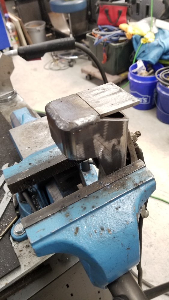

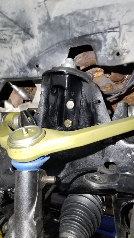

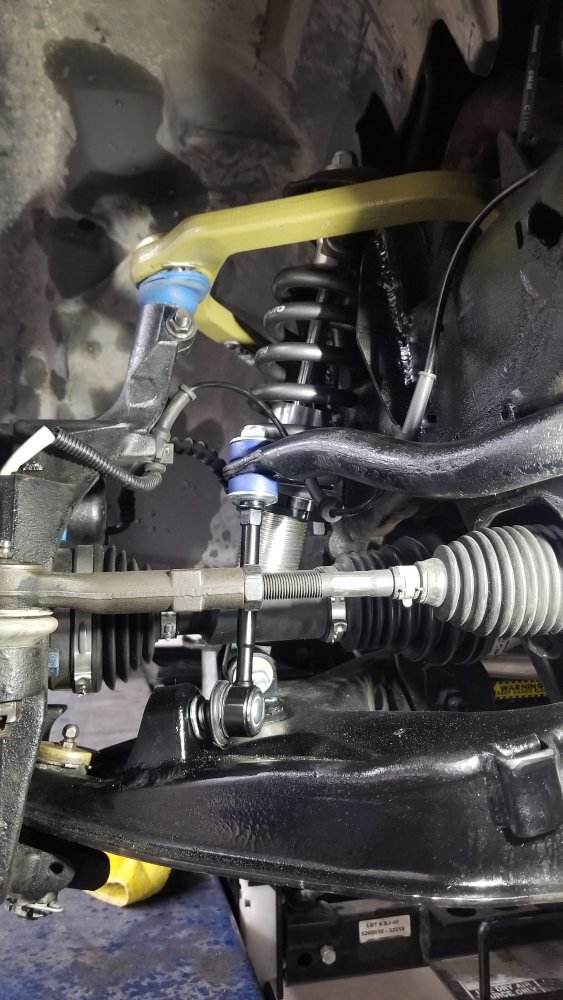

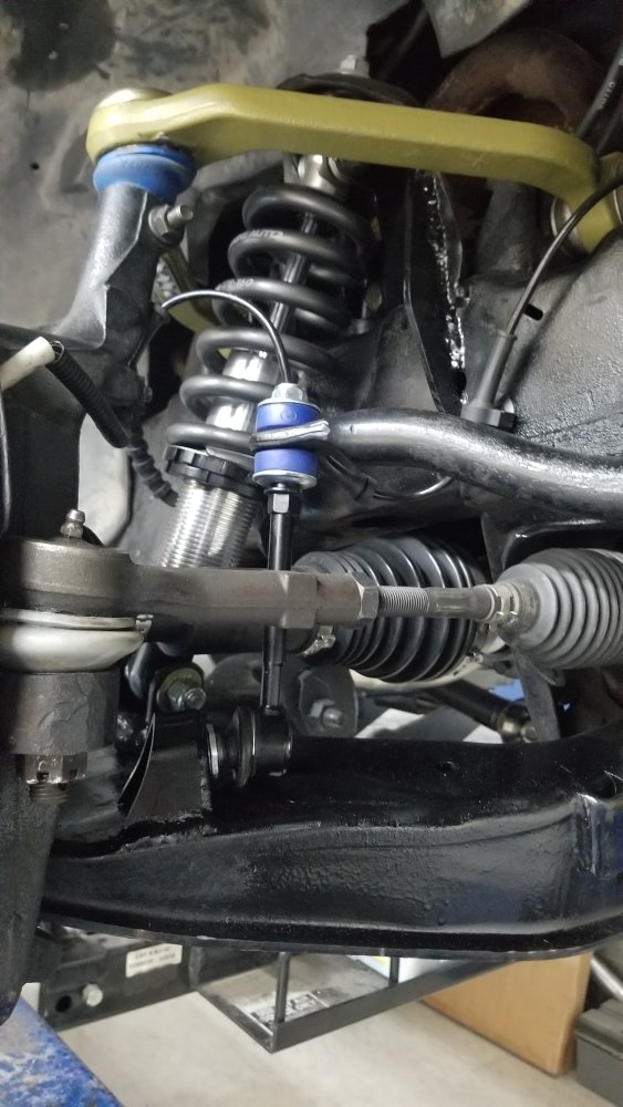

I have coilovers on my lowered awd Level II, I just made the upper brackets from a piece of box tube, there isn't much to them at all. And for the lowers just a regular shock mount is needed, just weld it to the lower arm.
The mounts they sell are nice to be able to bolt-on but come at a very high cost, if anyone has a friend that can do the most basic of welding these can built for pennies. And if you do the gussets on the frame as well someone's got to be welding those on anyway.

I'm guessing you made the sway bar link mounts as well? Way nicer setup than stock. I may copy that...
Just out of curiosity, which shocks and springs did you go with?
Did you plate or otherwise reinforce the lower arm for the shock mount? Those arms arent exactly the thickest steel, I'd be worried about it getting stressed over time and cracking/breaking. Lots more pressure on that arm supporting the whole vehicle.. rather than just damping.
So what is it that you think the torsion bar connects to? That arm has supported the whole vehicle from the day it rolled off the assembly line.
I can see where he is going with his question. The pressure point has moved from the hex eye in the control arm and is concentrated there. With the coil over, the pressure point is moved further down the control arm.
Granted, shock damping forces were taken up by that area already. So it might not even be a problem but with that section now not only taking the damping forces but also supporting the vehicle, it is a valid question to ask in my mind. The type of forces enacted in that area have changed.
That’s pretty much my thoughts too. You’re changing the dynamics of it, the area around the torsion bar is reinforced so I’d think reinforcing around a coil over mount makes sense.
IIRC, you've also got the bumpstop making contact in that area. When bottoming out the bumpstop is going to be taking the full weight then some, so that area of the control arm is also going to be supporting that much force. That area of the control arm has to be designed to take it.
Not saying that I wouldn't rather have the reinforcement provided by the adapters that have been sold. I just don't think that not having it is a problem.
