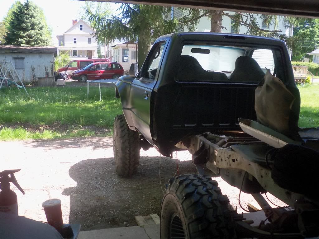

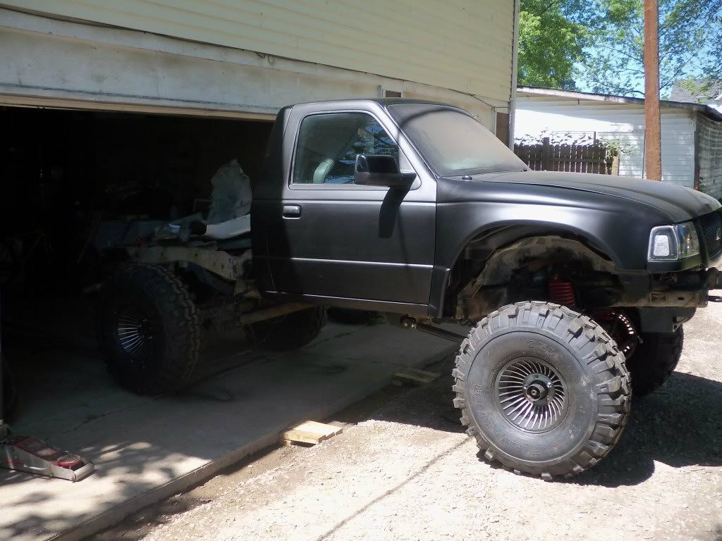

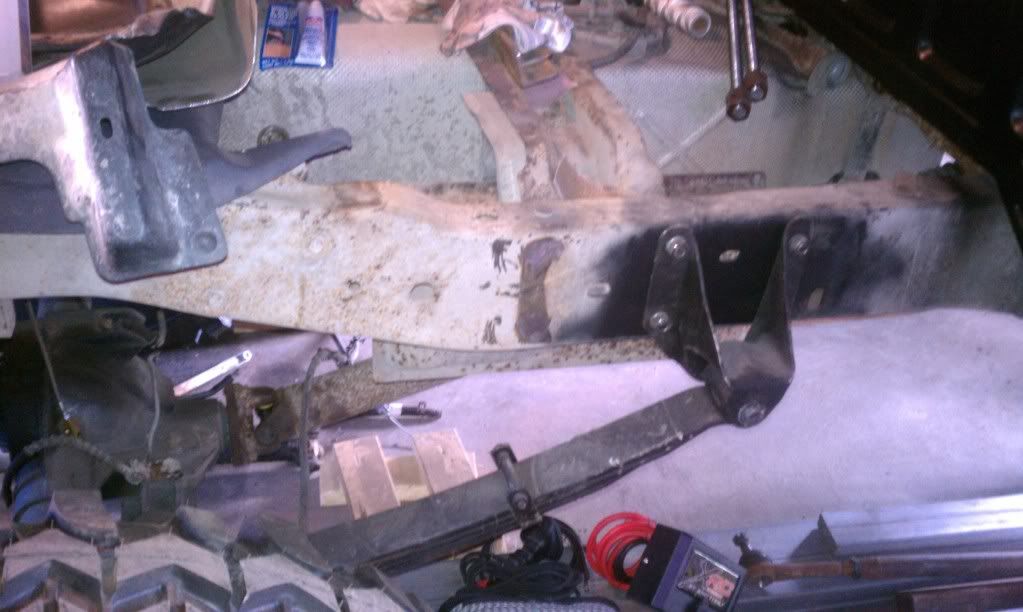

it happened pulling out of my garage.. i had to use a prybar to pop it back up. i read on pirate that u measure the flat length of springs - shackle length + 1/2" = the distance from bolt hole to bolt hole on the 2 hangers. so 63"-4.5"+1/2"=59". they are currently at 60.5" which is what i got from following the tech write-ups on here. 59" seems kinda short to me.
why has nobody else had this problem?
Because you need to move your front spring hanger 6 inches forwards.....
Maybe the springs you used are longer/shorter than chevy 63's?
60.5" doesn't seem long enough?
I believe you need the longer shackles to make it work as advertised. If you pick up belltech 6400s it will fix the problem with it goin back too far. you just need a bit more angle for them to work with. I also realized your shackles are backwards. if you dont want to get the new longer shackles just turn your shackles around and that should fix it for a bit because of the angle in the shackle itself. I know it doesnt look right but it is.
What year of chevy spring did you use? Got more pictures of the complete set up?
You do not need the longer shackles to make it work at all....
Nor does the orientation of the shackles matter...I have one goin each direction on my truck...
the springs are procomp 5.5 lift springs from a early 90's model 1500. i moved the front hanger forward 6". the springs are backwards from what they are supposed to be for the stock ranger. (i flipped them around to move my axle forward so i could use the stock driveshaft, only about a 2" difference. works perfect) the stock 2" blocks are on until i lower the front a few inches.

the springs measure 63" and they are the stock shackles.
That might be where your issue is (most people use stock C1500 springs)
A longer shackle (BellTech 6400 or similar) should stop that from happening.
